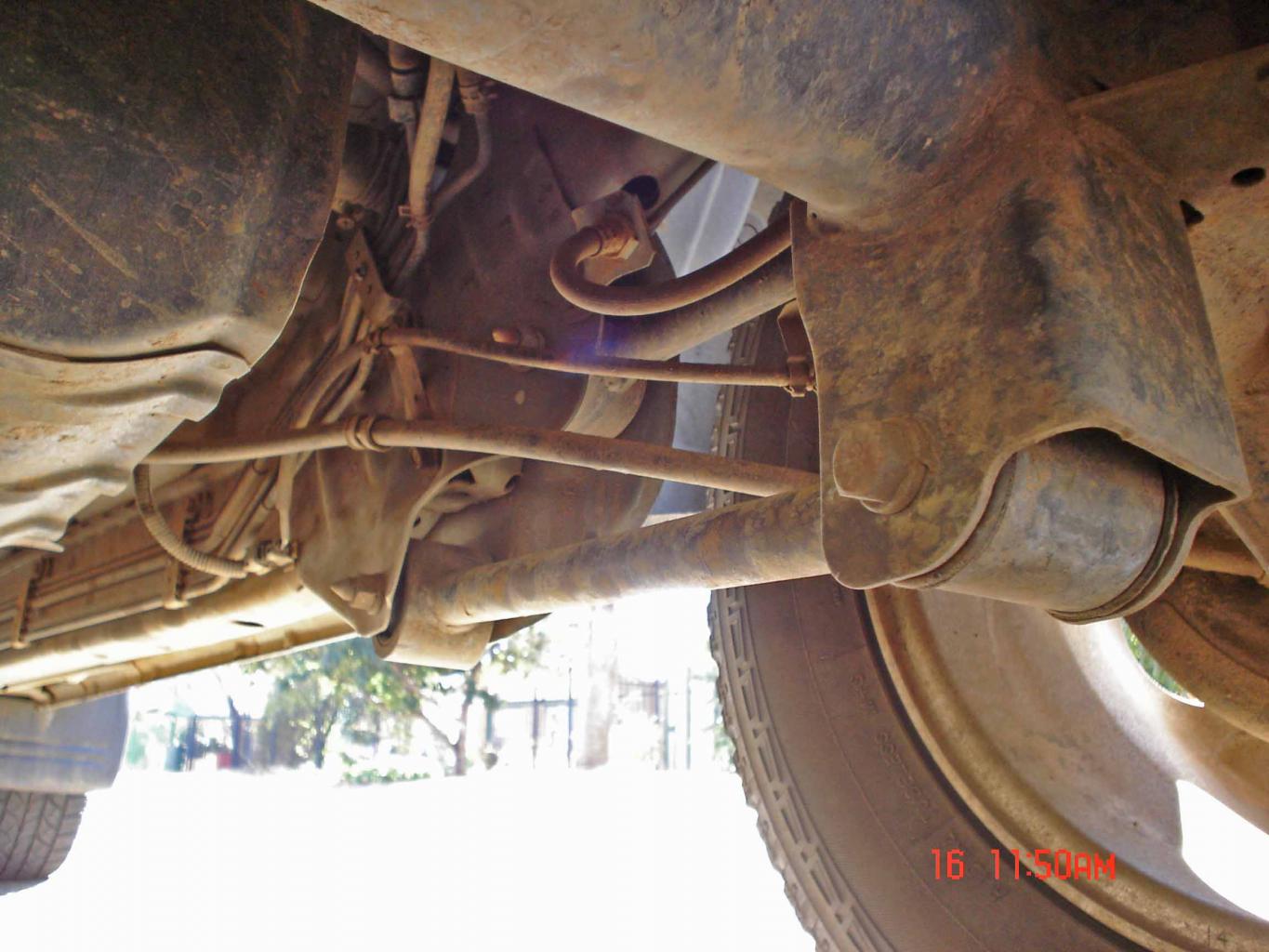

No faults were found on the shocks. While the car was on the ramp the techie pulled the body down to make the shocks contract and expand again. We noticed movement (back and forth) in the "joint" of the arm that holds the axle. See pics. The one pic is of the arm and the second a close-up of the joint. There is a rubber inside the joint.
My question: Is there suppose to be "play" (forward/backwards) in the joint?
So, after R 1800 the clunking noise remains.
I had the rubbers replaced, but to no avail. The rubbers themselves was not that expensive, but the labour
. They had to send it to someone else to "press" in. I can, however feel that the rear end is more stable. When in a corner with uneven surface it used to feel "loose".

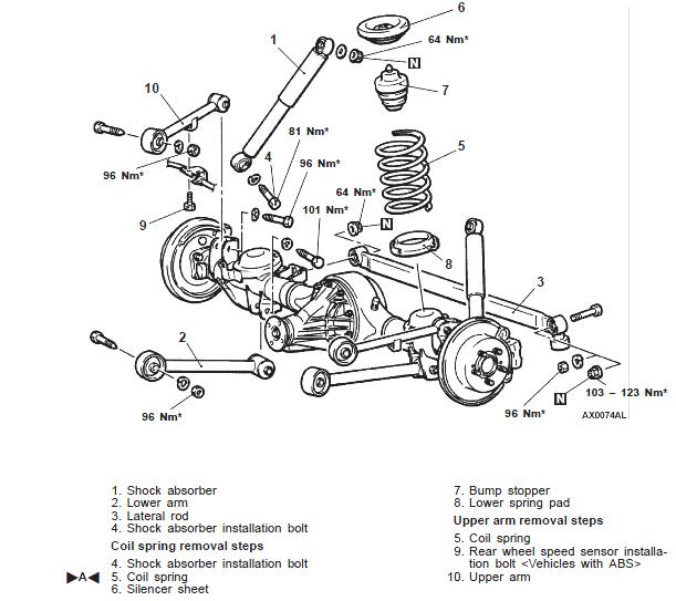

Hi Jonny
Just check that if your "silencer sheet" is fitted between your spring and body. When I did my lift, the guy doing the fitment "forgot" to replace it resulting in a "clunk"

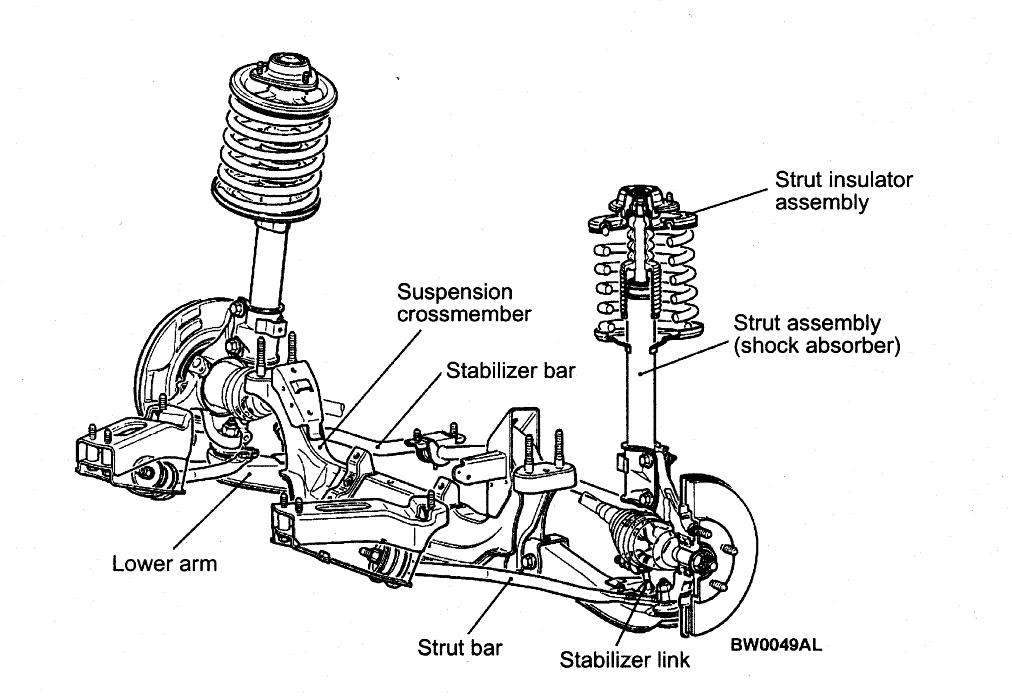

Do you perhaps have a sketch of the front suspension for me?

I've got it, will post it tonight.

Please post the front suspension drawing. Thanks again.
