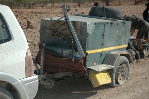

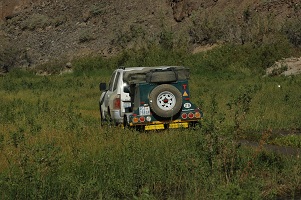

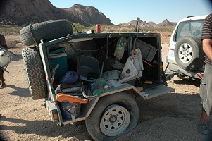

Well I once had a bad experience that certainly put my gooseneck tow ball to a severe stress test when I was unfortunate to barrel roll my camper trailer of about 1.2 tons. In spite it rolling over about 5 time the tow coupling did not come off and neither did the ball break off. It had a swivel coupling and also did not effect the car much. As it rolled over onto the roof the top front corners of the trailer were ploughing into the soft gravel road surface leaving trenches behind large enough to plant potatoes in. In my opinion those that break so easily had flaws in. Mine has now proved itself and I am happy to continue using it now pulling a Echo Chobe.
From the photos you can see how the tow bar itself pulled away from the bumper under the force. It used to have the bumper protection plate right up against the bumper
How did it happen you may ask. Well I’m still not sure. Factors of influence were low inflated tubeless tyres on the trailer and non-tubeless rims, speed a little high for corner, anti-skid on the Paj caused slight breaking that swung the trailer tail out. It happened in Kaokoland a few years ago. Had to desert the trailer there.
DSC_9762 - Copy.JPG (65.73 KiB) Viewed 38822 times
