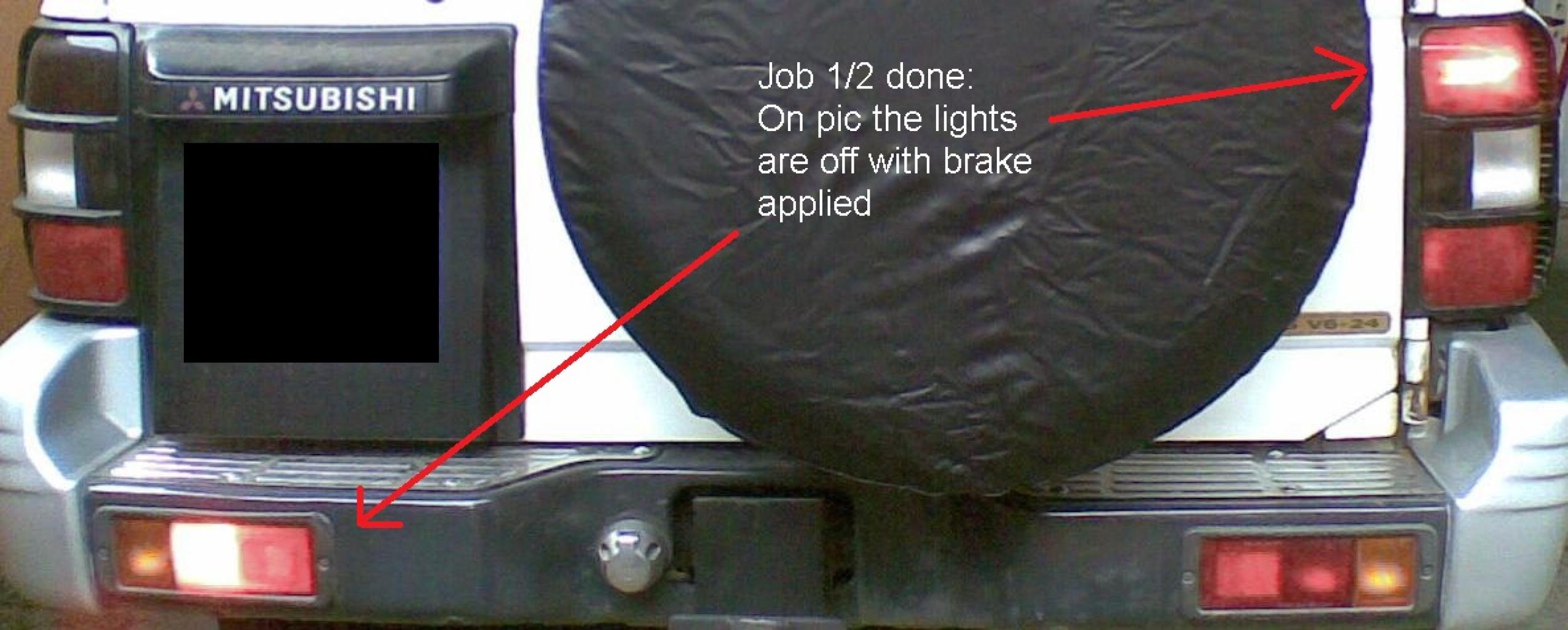

As I mentioned in a prev post I wanted to utilise the top cluster of the back lights for brake lights.
Well I did it this morning - was a very easy and cheap conversion - under R20.
I kept in mind what Paw_by_Paw said about his fuses popping so I split the back lights and brakes lights:
The bottom cluster now contains only the back lights and the indicators.
The top cluster is now made up of the brake lights on top, reverse lights in the middle and fog lights at the bottom.

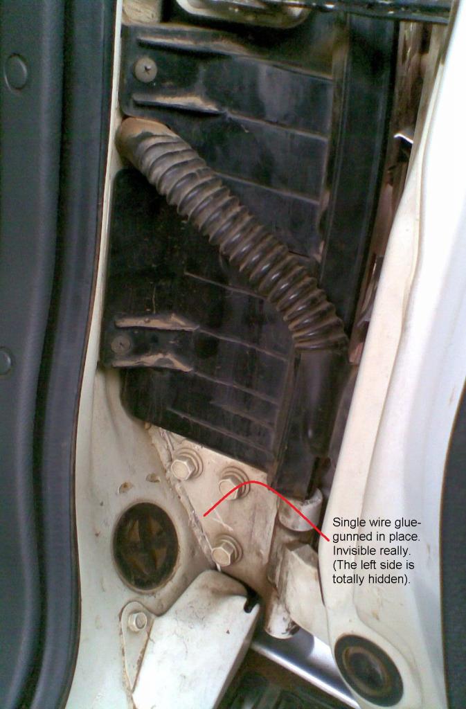

All I did was to cut the wire going to the bottom brake/lights globe and relayed it back to the top clusers.
It is very easy to hide the single wire (I stole a earth from inside the top cluster) to the top as you will see (or not see) in my pics.
I just could not find the right side socket so I glue-gunned a small one in place until I can replace it.
