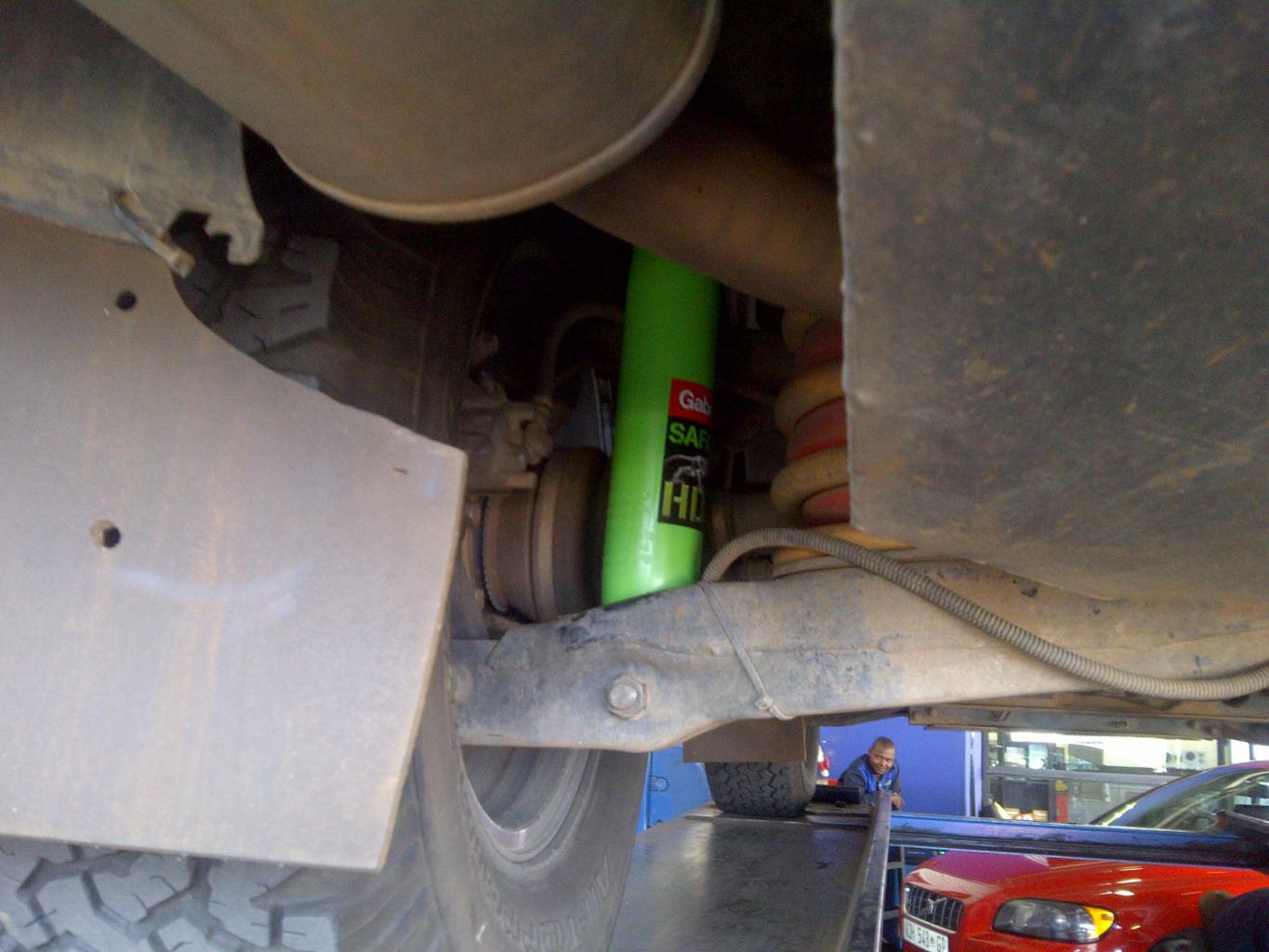

Top would be ideal, but I have mine routed from the bottom for the exact reason that you mention regarding the space available and so far they have worked well with no damage sustained.
If you have a look at this pic I posted on the shock thread you will see where my airpipe runs and then enter the swingarm?https://www.pajeroclub.co.za/forum/down ... rokbox.jpg Looks a bit sloppy looking at it now again
, but it has survived thus far
