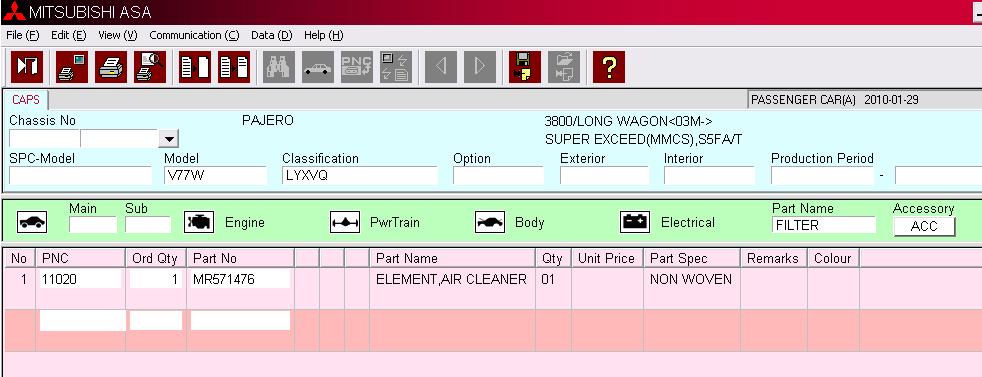

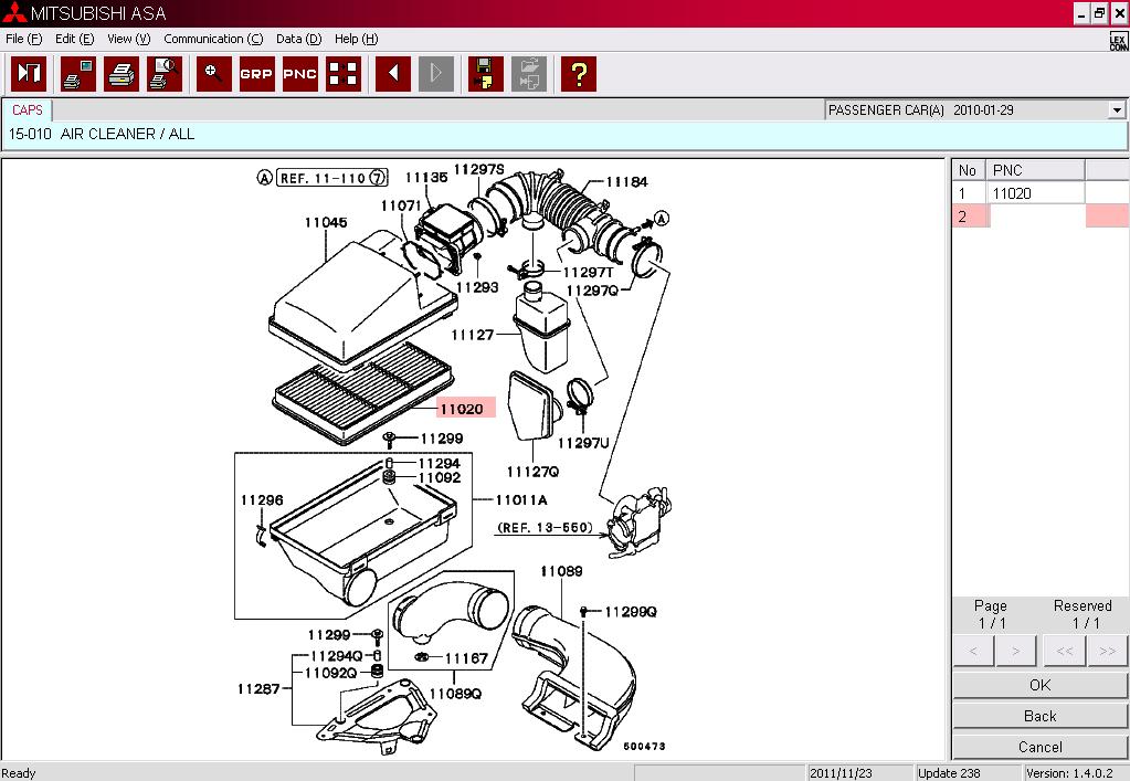

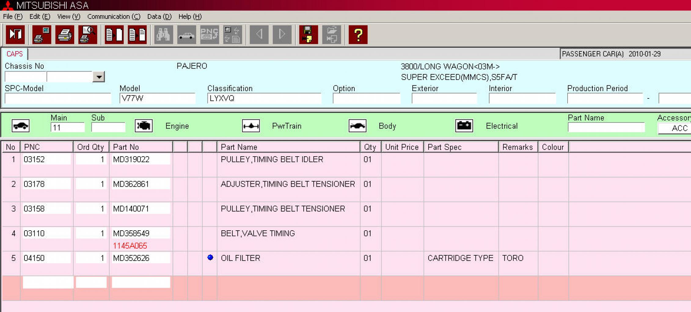

I get these parts on MMC ASA
Delo400 can probably be used but as the 3.8 is more like a racing engine I would get the appropriate helix synthetic oil.
I have seen engines on helix (including my passat 1.8T) and those engines are smooth and spotless.

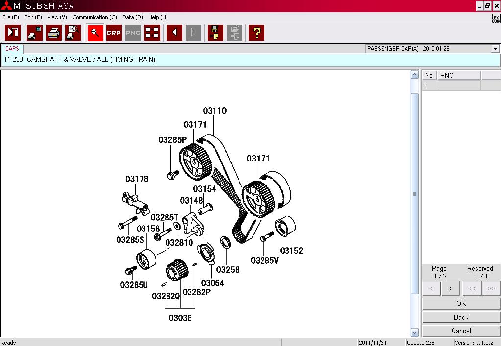

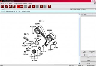

Notice that I included the tensioner part number as well. IMHO the tensioner is just as important to change as the belt.
Part location illustration below
Marius,
You are a star.
1)The part numbers on your list correspond with the numbers on my list - GREAT.
2)The tensioner is included - thanks for the heads-up anyway.
