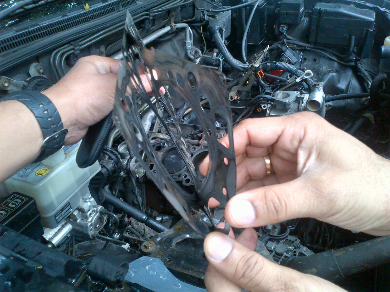

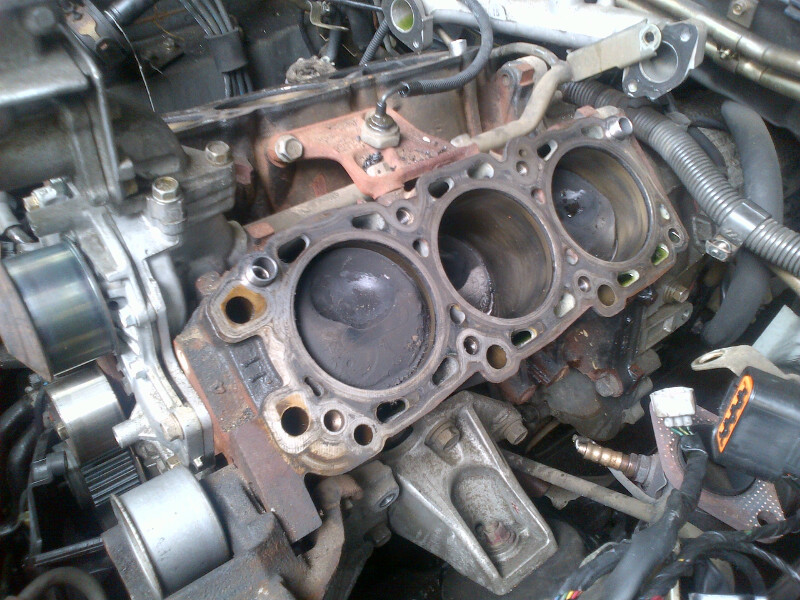

The gasket (also attached) have been obviously compromised and released gas (not yet oil) in the radiator.

Please comment. It feels very frustrating...
Really don't know what to do at this point!
