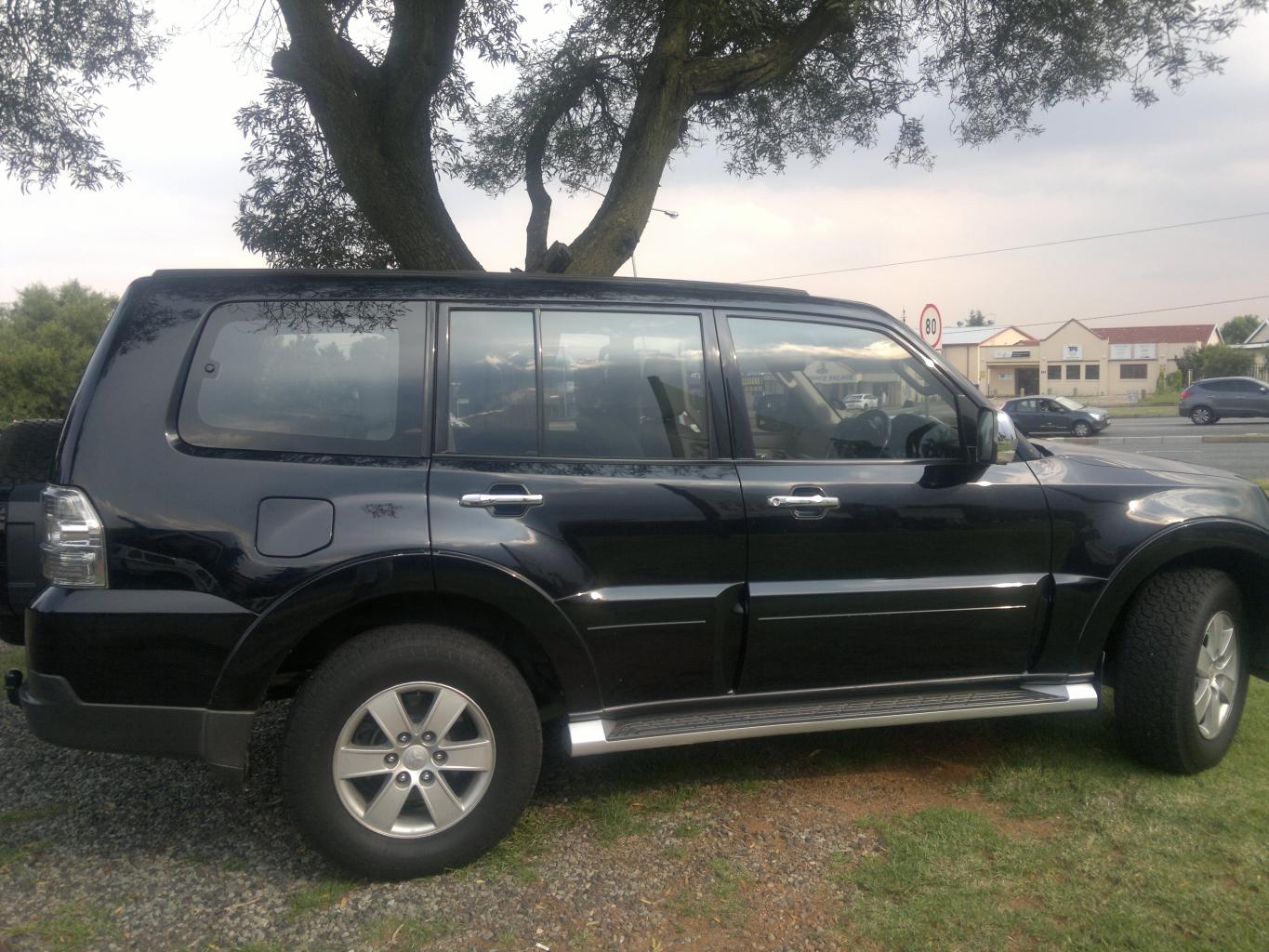

Sorry mate. You’re buggered. Once you start looking on Autotrader the buying is not far off!
Ended up buying my Pajero when a mate asked me how much his is worth. Looked on Autotrader for values and bought this one! And now I’m too afraid to take it into the bush. Sad I know…
