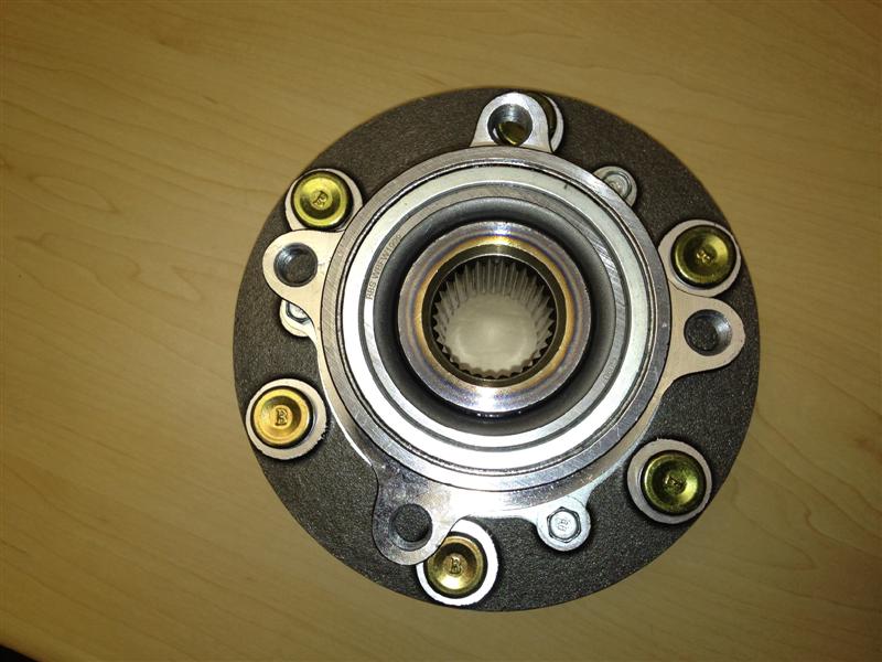

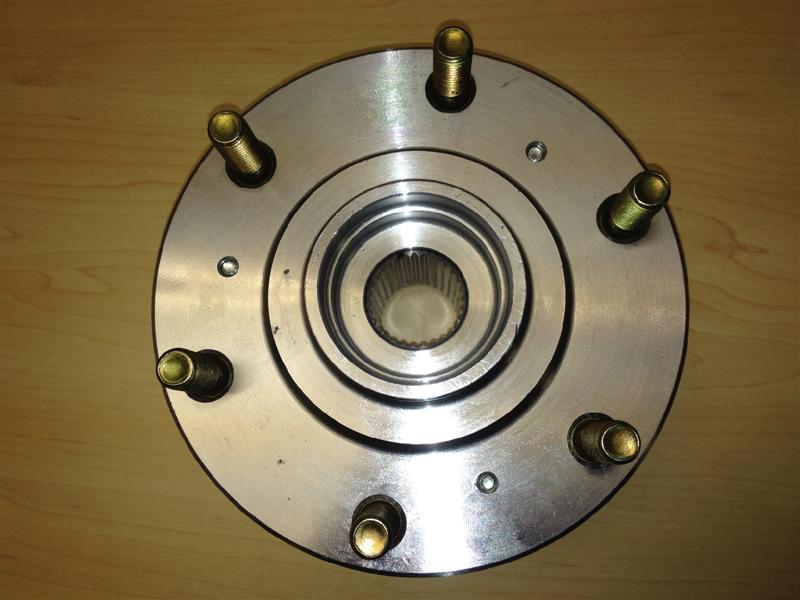

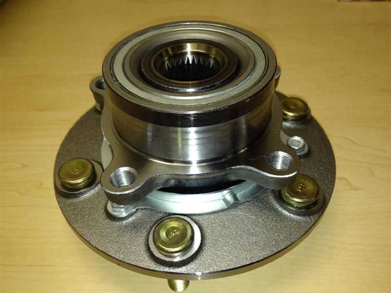

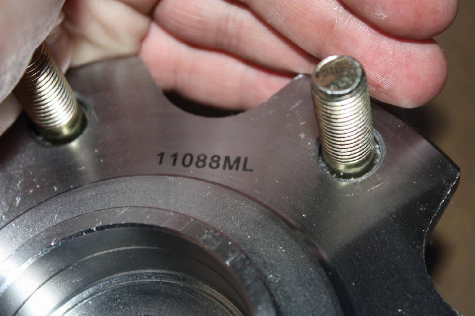

Here are photo's of the Triton 2007- front wheel bearings , can anyone maybe confirm this ?

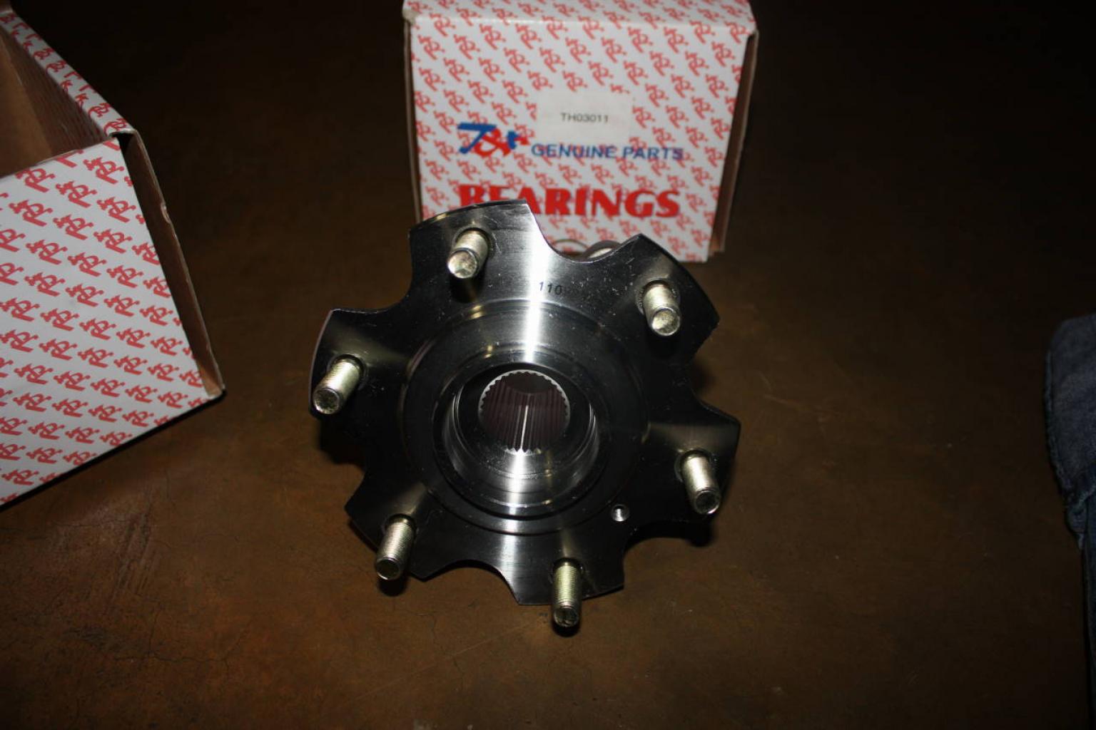

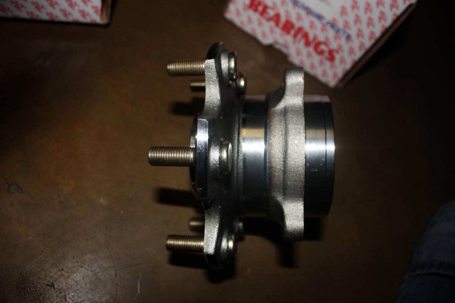

Took the Automatic in Yesterday afternoon to be fitted with some new rear bearings ordered from Masterparts at a fraction of the price from stealers.
Ordered the Bearing hubs paid and delivered in 3working days.
