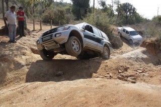

Went to Dewildt yesterday for some off road training with Engel from the 4x4community forum. Everthing went well but now and again specially on some tricky cross axel twisters and climbs it would seem that the center diff will disengage it self.
This happened while in low range. No lights were flashing at all but even with 3 wheel on the ground the front wheel in the air will be spinning and receiving all the power and you can hear what seems to be the gears trying to engage again.
Swambo managed to get a picture of that instances it did it.
3 Wheels on the ground Low range engaged and rear diff lock also and one wheel spinning in the air.

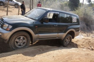

shifted the 4x4 selector box a few times and next it just climbed out off the hole like the obstacle weren't even there.
On other occasions on same obstacle I have no problems.
Where and what can I start looking at to solve this?
3wheels on the ground, 1 in the air spinning with lowrange and rear diff lock engaged
Driving out after selector box shifted a couple of times

looks like the actuator (not sure if it's vacuum or electrically operated) is misbehaving. I suspect the only way to fix is to open the transfer case. :(
