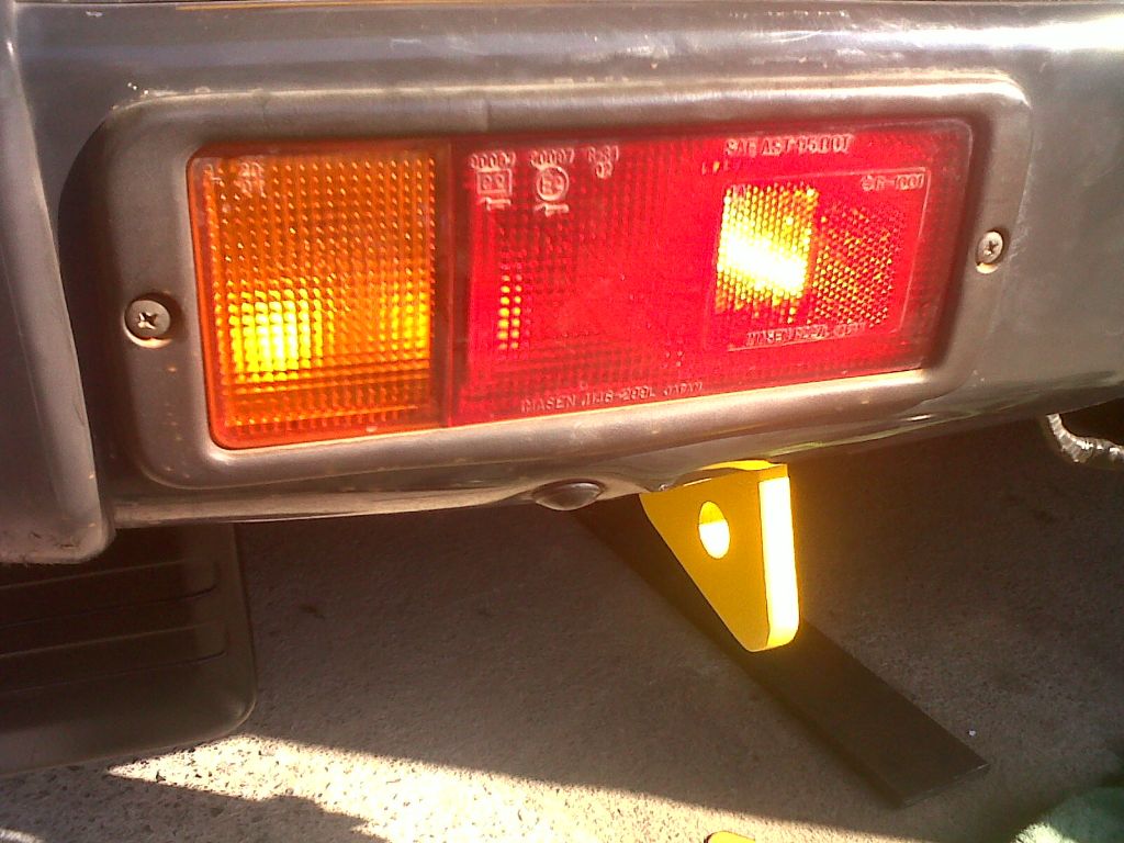

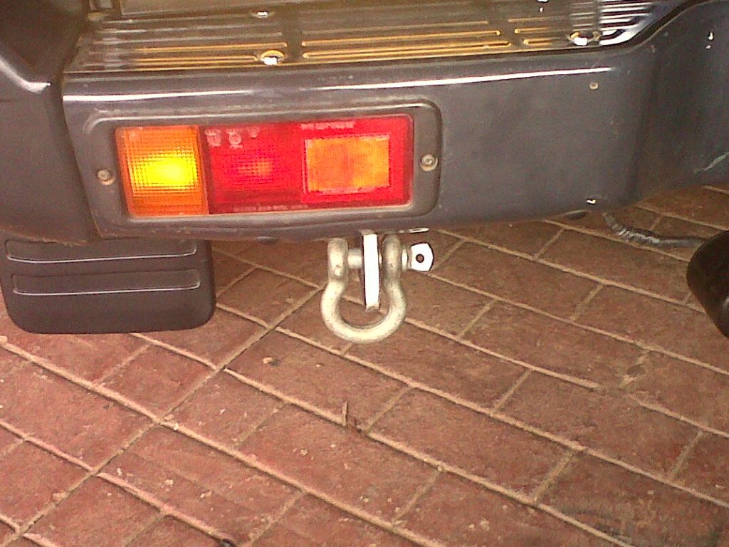

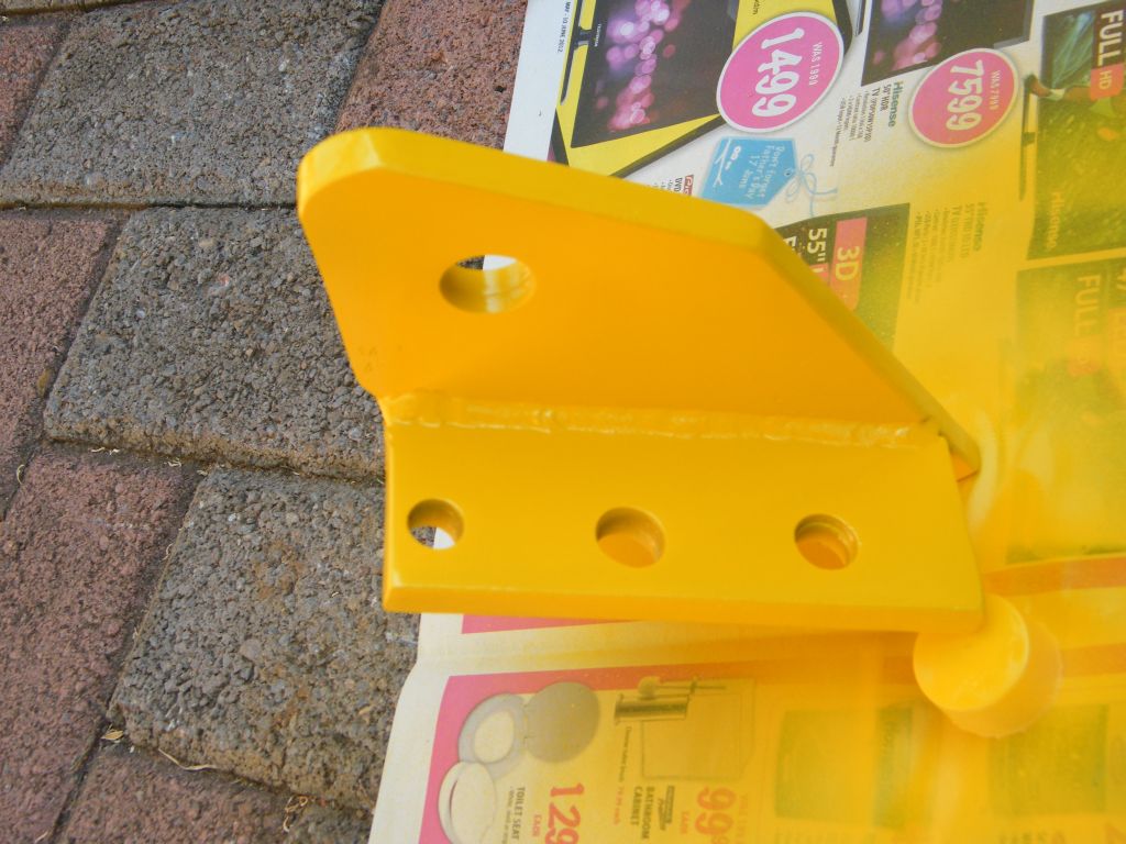

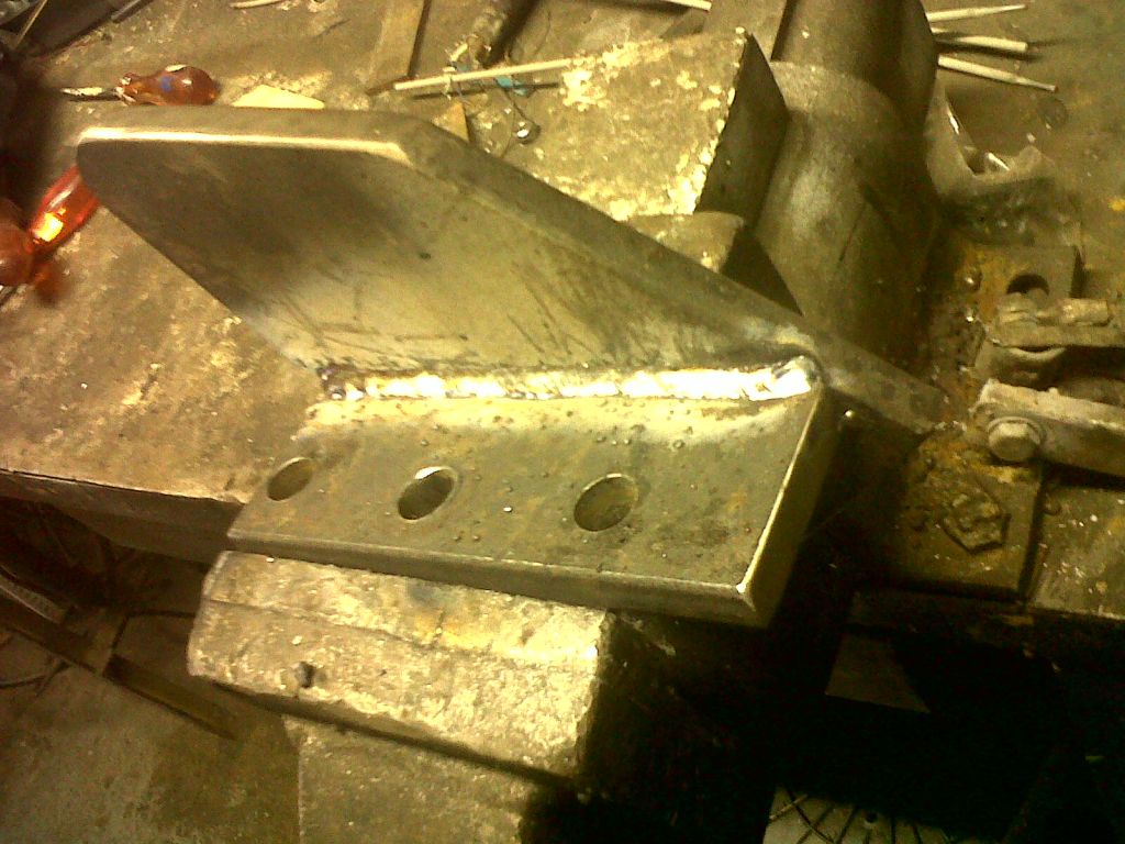

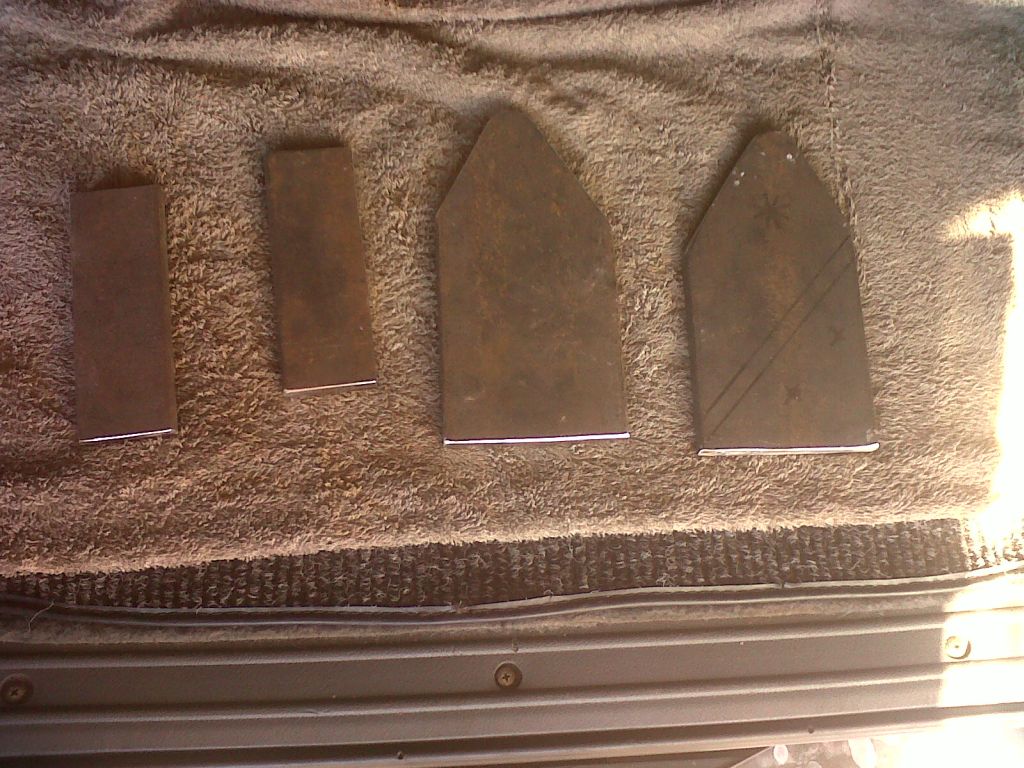

So I built the recovery point and heres the proof!
I left the jacking points out for now-sure I'll regret it later
Used the holes that was already there to bolt it on(3x10mm,2x12mm high tenstile bolts)
My dad hates the yellow but hey its my van so who cares I like it!!
Please comment!!
