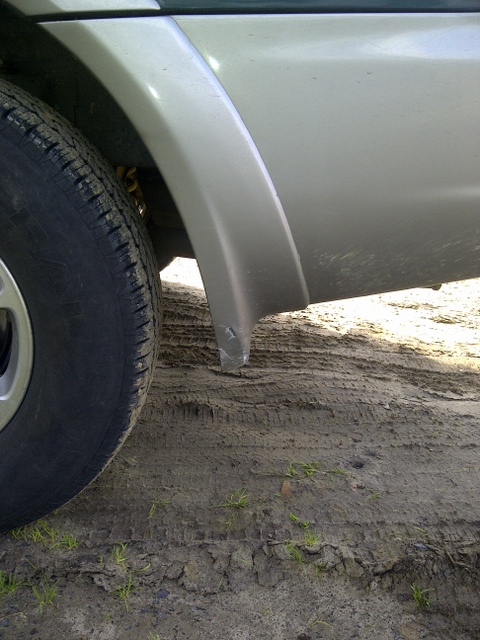

I have just come back from a 4x4 weekend with some of my mates who drove a 2011 GX Prado and a 2010 d4d Fortuner – all of us bog standard- no mods. I was looking forward to this weekend for a long time, I even fabricated a belly plate to protect the piping/and vulnerable stuff under the Paj.
The fortuner had exactly the same tyres as I have crappy general grabbers that I got the vehicle with. Of all of the obstacles, I came across the worst, with the Prado faring best with articulation and ground clearance. I snagged every one of my plastic mud guards on the drop-off after rock that I drove over, and bumped my petrol tank and tore off a section of my rear bumper around my removable tow hitch. The Fortuner has black plastic flexible mudflaps that just bent out of the way when scraped over a rock, and the Prado did not have any, and did not touch either.
Is there anyone who has the same problem? I was thinking of carefully trimming the offending piece of plastic off and fitting rubber mud flaps fabricated out of conveyor belt? Suggestions would be most welcome. I have already thought of lifting the vehicle, I have Gabriel HDP’s with lift the front 30mm, but need to consider spacers to lift more.

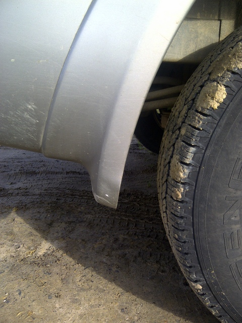

A gen 3 faclift stopped on site yesterday and saw that the mudflap design has changed from the original Gen 3 that I have. Looks like Mitsu saw the design flaw and changed it. I wonder if I can retrofit the wheelarch, as it is not a two piece as my paj has?

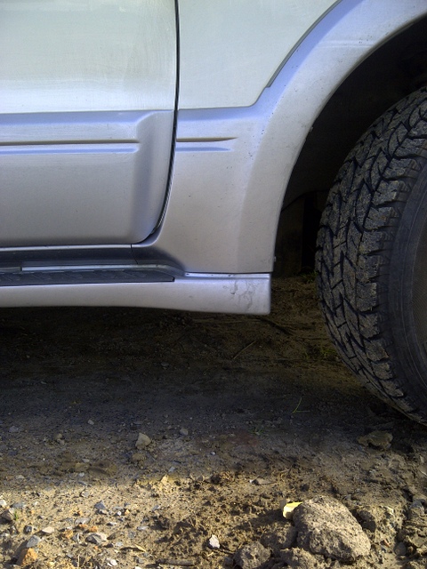

It can probably be retrofitted but it will be very costly.

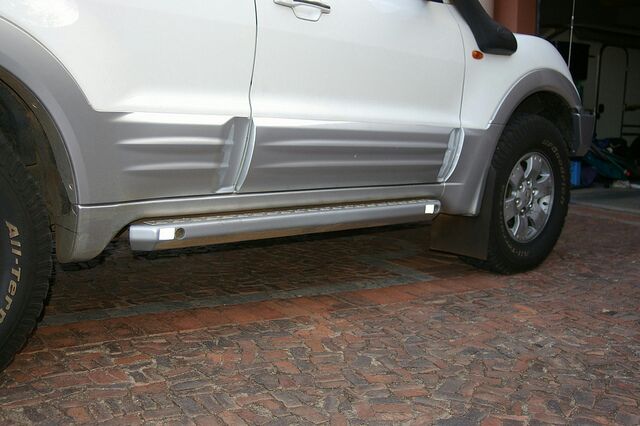

I will rather cut the bottom part off and get Lynx 4x4 ro build you a rockslider sidestep that runs the full lenght. I cut my front ones as they were very tatty and when I had the sliders made at Org( No longer making them before you ask) I asked him to cut further and put the sliders full lenght, but he refused as he felt inadequate as panelbeater
. Still looks good I think? As you can see I also fitted longer rubber flaps for those Namibian gravel touring.
