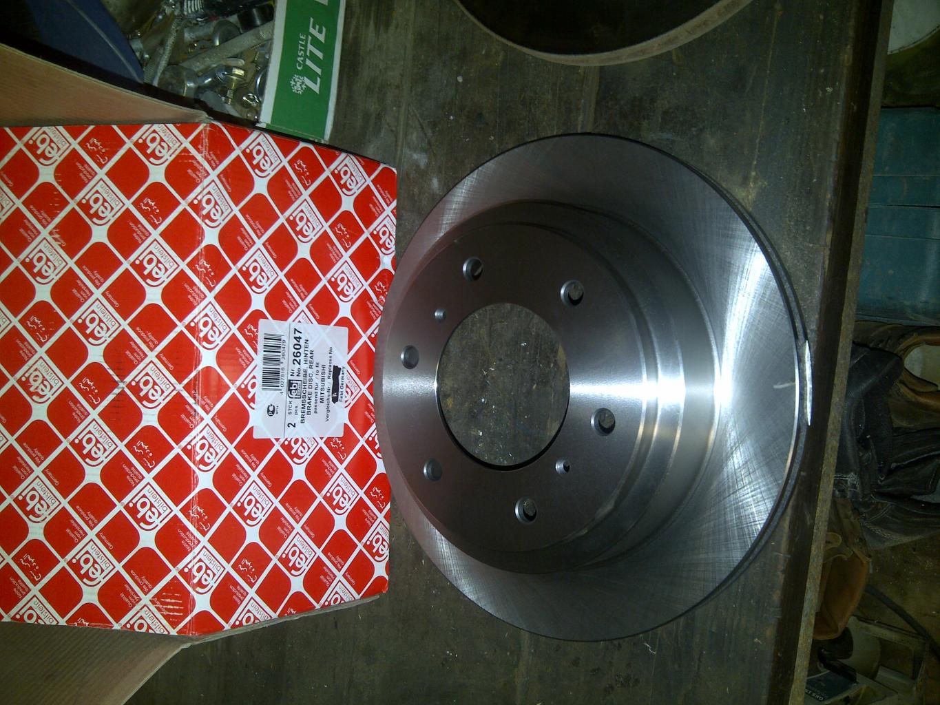

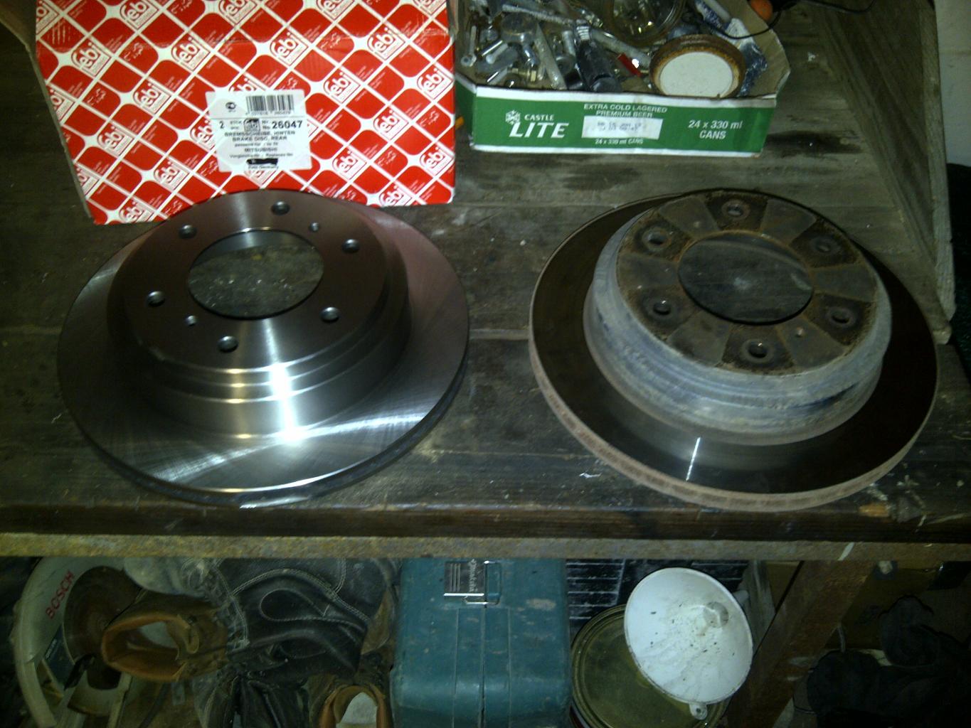

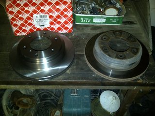

I picked up a shudder under moderate to heavy braking emanating from the rear of my Paj, and so I had a look at my discs, vernier said they were at 19.4mm, min was 20.4mm so I decided to buy new discs. Found some (after a lengthy search) at suburban spares in Maitland for R 690.00 for the pair of Febi(Bilstein) made in Germany, not too bad I thought.

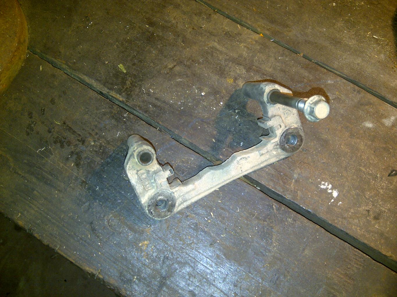

When I removed the old discs, I found that the slider pins had seized on the left rear wheel. After much swearing I managed to free the pin and cleaned the up with a wire brush, and greased with normal gear grease I had lying in the garage, is this the correct stuff to use?
Braking is MUUUCH better now and that irritating squeal has disappeared too.
