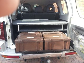

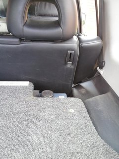

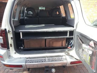

If you are considering the Pioneer 50l angled water tank then I think you will find that it sticks up above the level of your current raised shelf (the one you show with fridge and ammo boxes standing on).
I fitted a Pioneer 50l in my Gen3 earlier this year and had to raise the shelf per pictures attached so that the shelf would overlap the top of the tank. By an amazing coincidence the height between the raised open shelf and the inserted shelf is perfect for six-packs!
Although we generally travel with the 2nd & 3rd row seats removed, the Pioneer tank is fitted so that it does not have to be removed when the 2nd row seats are in place.
Picture of thumb with progressively modified FrontRunner storage system in background. Slide in extended position.

Showing drawer system in stowed position and water tank outlet bottom right
Top shelf overlaps top of water tank maximising shelf depth. Tank positioned so that 2nd row seats still fit. Top shelf cut away at rhs for ease of water tank filler access
