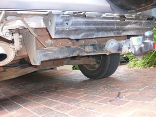

The towbar with poor mounting brackets
I have a 2006 Pajero 3.2 LWB which came with a towbar fitted by the agents. I religiously checked the bolts before my trips as I tow an off road trailer with rooftop tent.
On returning from a trip to Mozambique we developed an annoying squeak every time we went over a bump and the trailer put pressure on the towbar. On returning home I checked to find out that it was not the suspension but the towbar. On checking I found there were no horizontal bolts holding on the towbar only vertical bolts. I only discovered this when I compared my towbar to that installed on my friend Pajero.
As can be seen from the attached pictures this caused the metal to crack around the mountings. Luckily I caught this in time and could replace the towbar with a better quality unit that had brackets to facilitate horizontal mounting bolts.
On checking other Pajero's I have found that many do not have the horizontal bolts installed even though the towbar has place for them. I can only think they are not installed as it is a bit of a job and one needs to loosen the rear aircon box to get the RHS bolt installed.

Just checked mine and am quite relieved that a proper job was done - credit to Mitsu East rand who organised it!
The bracket that sits vertically is actually larger than your drawing, and has 2 bolts!
See below (angle not as good as yours). :-?

Hi Karl (Gemaskerde Tuinvurk) thanks for the picture as it shows the correct brackets as well as the bolts in place. Hope this will help Jimmym feel more at ease.

This picture is of the RHS mounting bracket, which is easier to see the full bracket. The big difference between the new towbar and the old is the fact that the vertical steel plate goes past the chassis up to the higher mounting point, allowing for horizontal bolts. If you look at my original pictures you will see the vertical steel bracket is bend at 90 degrees for the 2 x bolts with a steel round bar welded into the bend.
