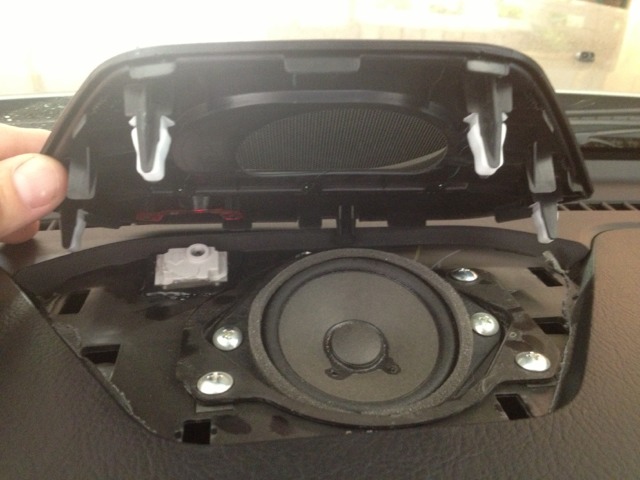

Since the rattle originated from somewhere near the centre speaker I decided to start there. I will have to remove the speaker in any case to get to the dash mounting bracket underneath. So I took the speaker cover off and there it was, the cause of the rattle!

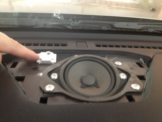

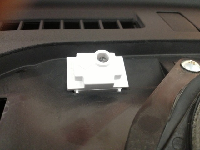

The red LED alarm light mounted next to the speaker sits inside a ABS plastic bracket mounted in the steel dash frame. The speaker cover holds the LED assembly tight against the steel plate, but all that shaking worked it loose and it starter to rattle!

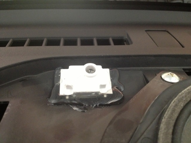

I removed the speaker in any case to check the dash mountings which were 100% fine. Replaced the speaker and decided to make a more permanent plan to stop that LED from ever rattling again. Well, easiest solution was to stick it to the steel using a hot glue gun (see before and after pictures). Then I replaced everything and took it off road, rattle gone!
