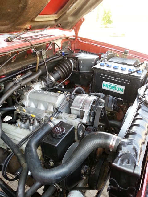

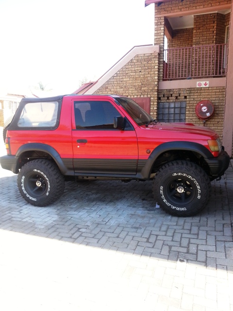

Hi guys,im busy with a COMMY TRANSPLANT,3.8 v6 with TH700 4 speed auto box onto pajero transfer case....into my 94 J-TOP PAJERO.

From my investigations I can't see the point in fitting the Commodore Engine. The Mitsi 3.8 will fit with less mechanical modifications. As far as the electrics go, the work would probably be the same but the parts are standard Mitsi.
Fitting the Commodore engine is a hotch potch of parts.

Also the "kit" was designed to swap the 4cyl Gen1 not the Gen2.
