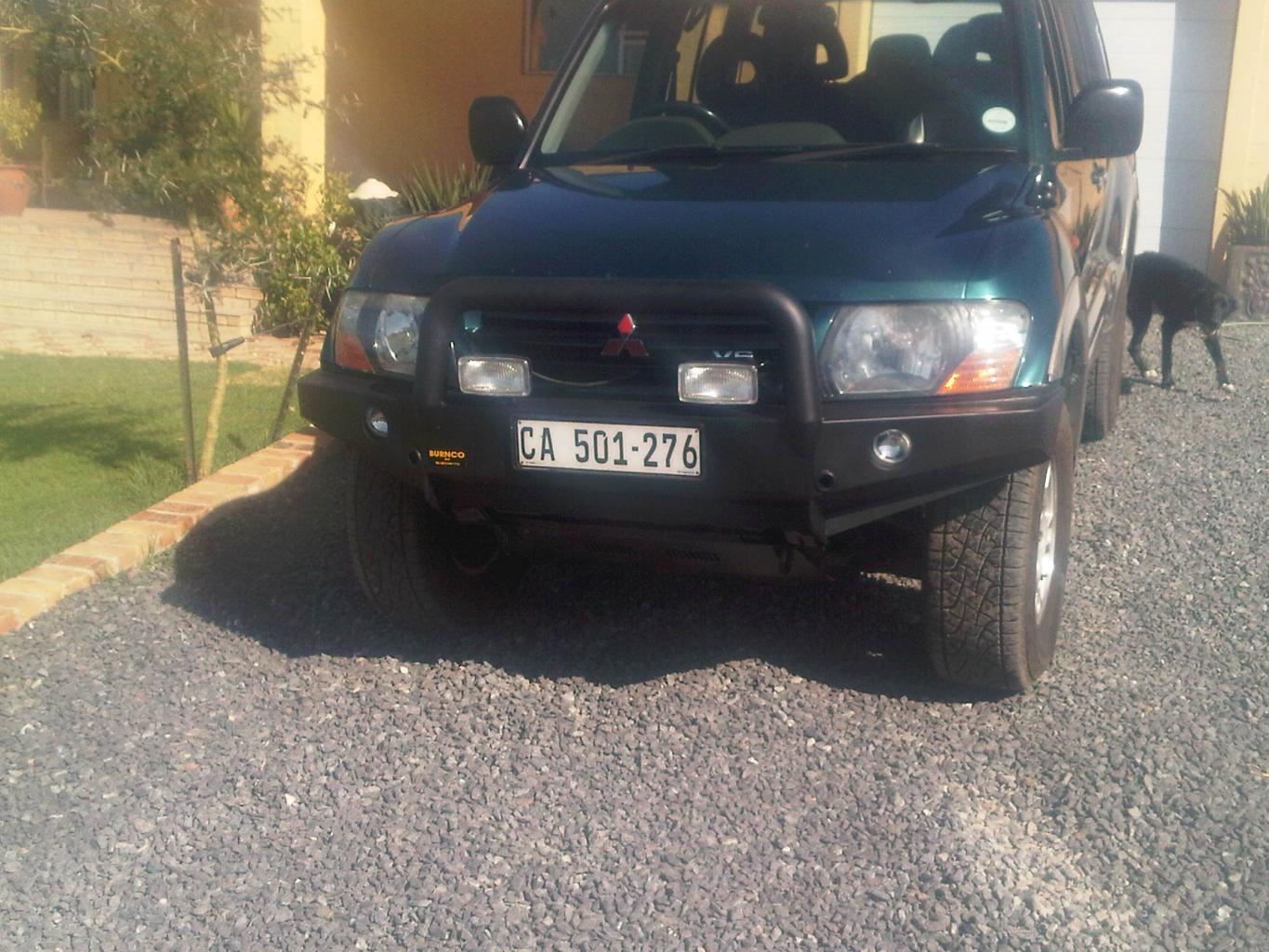

I just had burnco replacement steel bumper fitted yesterday. I like the look of it, no too busy and functional, excuse the terrible cel-phone quality pic, my lens is poked.
I see they moved my windscreen washer bottle to the space between the radiator and the bumper as it was always in front of the right front wheel behind the plastic bumper. On another note I am not happy as my paj is running a lot hotter then it did before the bumper was fitted, I think it has to do with there not being any cooling slots/vents in the number plate area. I am going to speak to Dino Burnett and see what we can do. It was 38 deg yesterday and my Madman stated screaming about the coolant temp hitting 105deg C....
with me testing it by cruising at about 150-160kph for 5 minutes... (which I used to do comfortably without the temp going above 84-87deg C for hours on end).

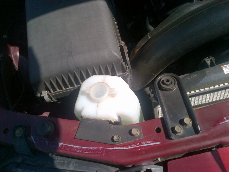

Attached is a pic of the new washer bottle, if tis is what you are looking for will do the paparazzi thing and take loads more pics.

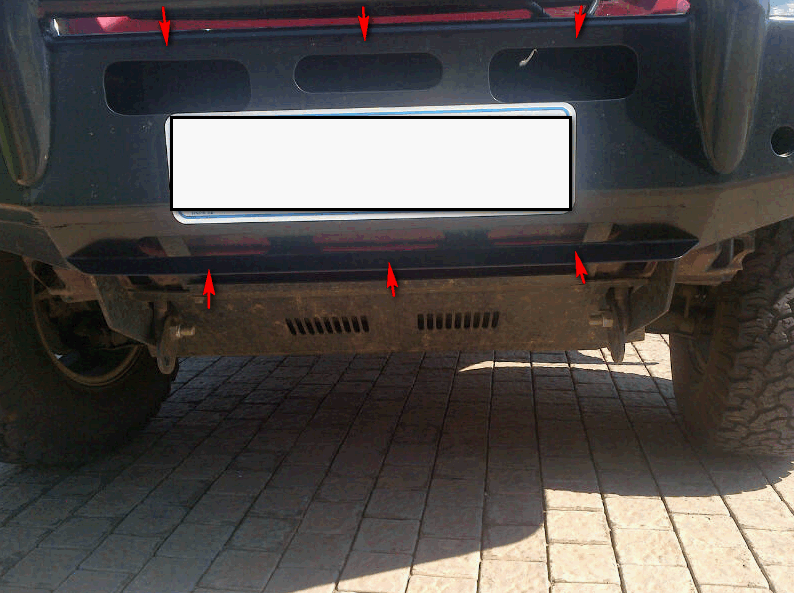

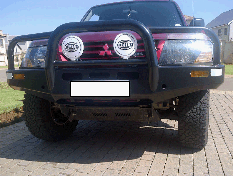

Nick, I have got the Nudgem fitted, and has 6 holes for airflow, have not bnoticed any change in temperature on my V6. Some pics below as well which may be useful.

I took my bumper back to burnco on Friday and they cut 5 big slots in the bottom of the bumper, all in the same area as your three lower slots (see your lower arrows). It is still running approx 10 deg hotter(92-98 now vs 82-89 prev), but I only pick it up due to my Madman which is digital, my analogue dash temp gauge stays in the same spot...
I am going to look for a bottle like you have fitted, the original one blocks too much airflow for my liking, as it blocks half of the 5 slots cut into the bottom of the bumper. Will post pics of the slots later today.
I am also going to remove my radiator and try to clean the fins up and blow the aircon condenser and radiator out with a compressor (from back to front). I will also try to carefully bend all the damaged fins straight to try and get better airflow through the radiators.
On another note the ATF is also running hotter at 75-85 deg C now vs 60-75 deg C previously, however I am no too worried as this is still well within operating temperature.
