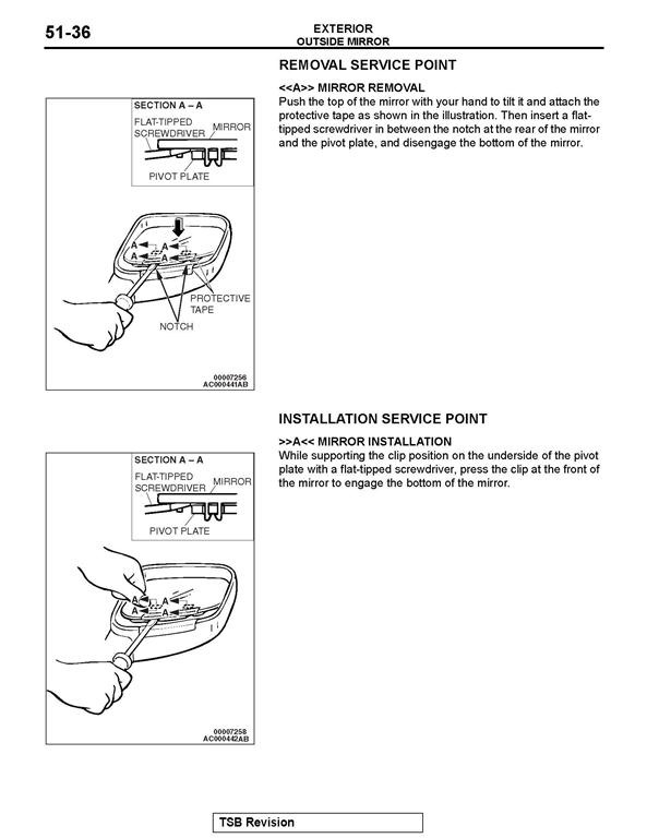

Ok got the replacement glass for the mirror , battling to push it back to clip in and dont want to break the glass , Mitsu wants me to book it in by them because according to them there is a special way that cant be explained on the phone ??
Anybody know what this special way is so I can do it myself ?

Ok , flatscrewdriver is your friend , why couldn't the Mitshu guy just tell me this ??
