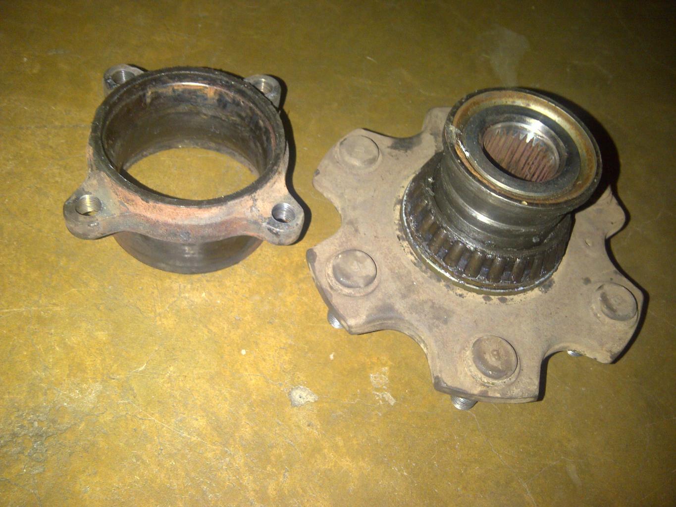

This is the remains of the wheel bearing hub.

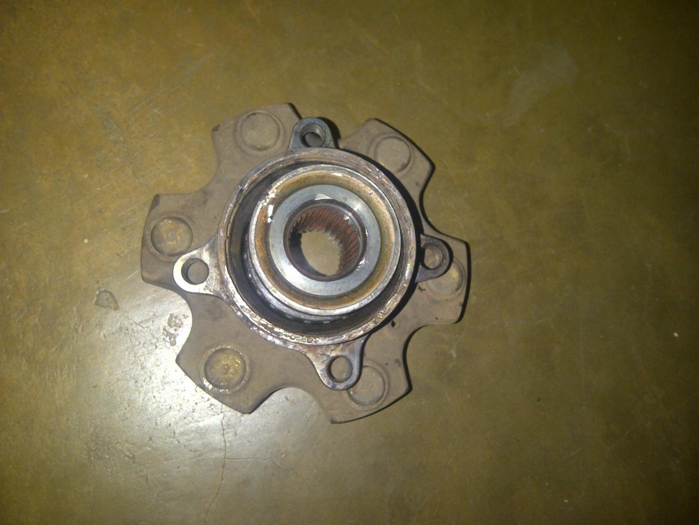

got replacement part from masterparts

Hi Johan, Interesting that this was your right wheel - it seems to be that generally the left ones gives up first.JohanV wrote:This is the remains of the wheel bearing hub.
How easy was it to change the bearing assembly?
