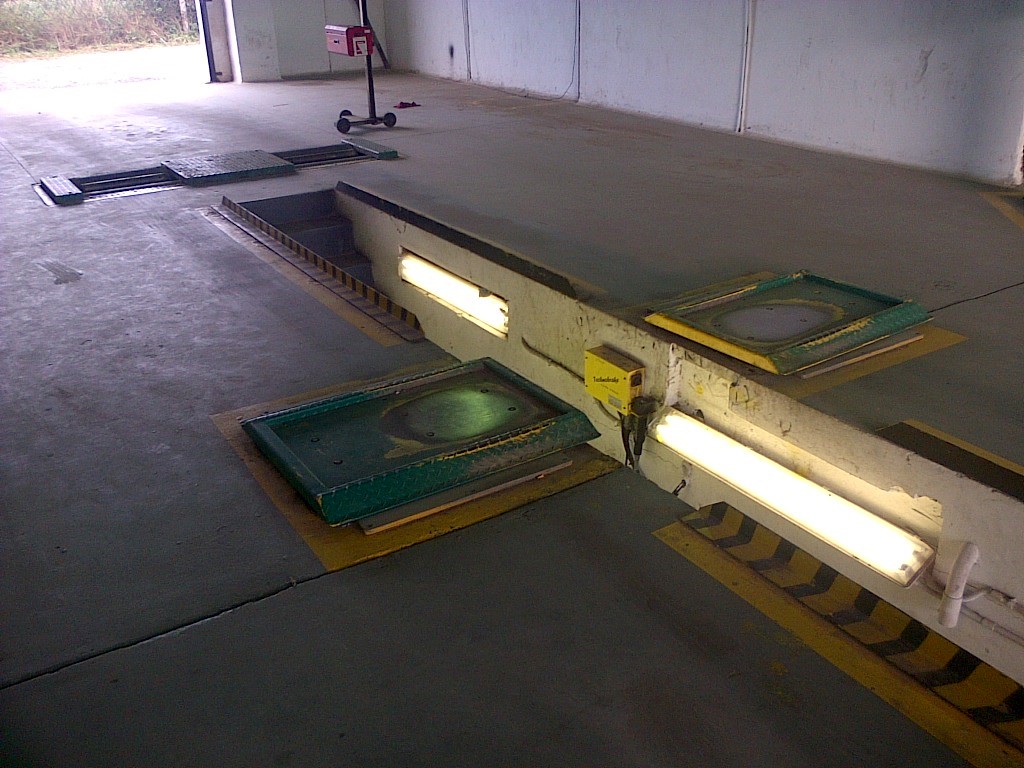

go to a dekra roadworthy station and ask them to put the car through the suspension stress test and have a look.
