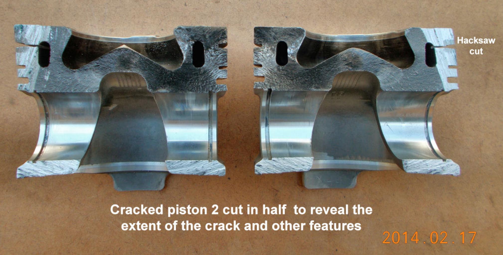

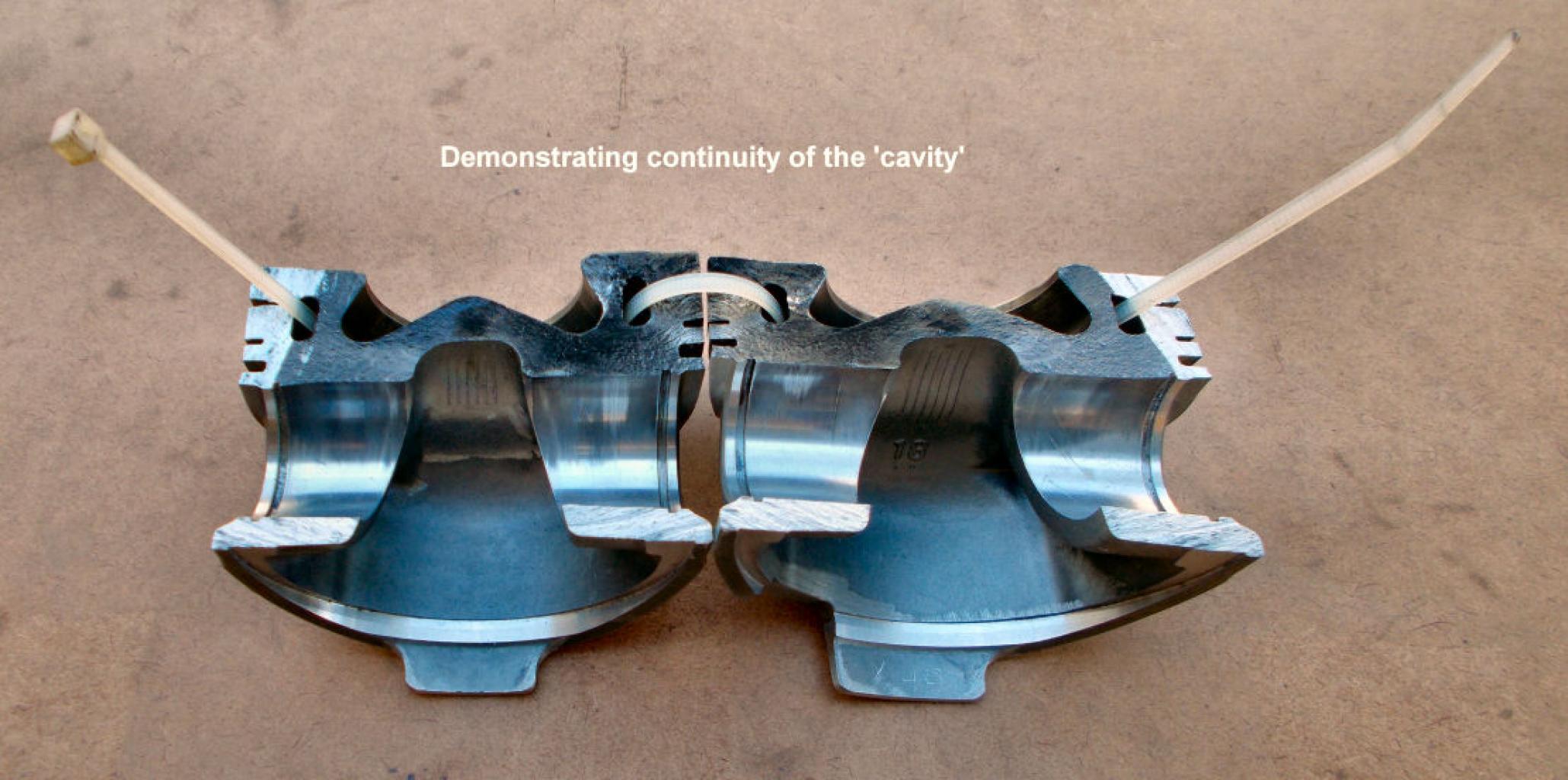

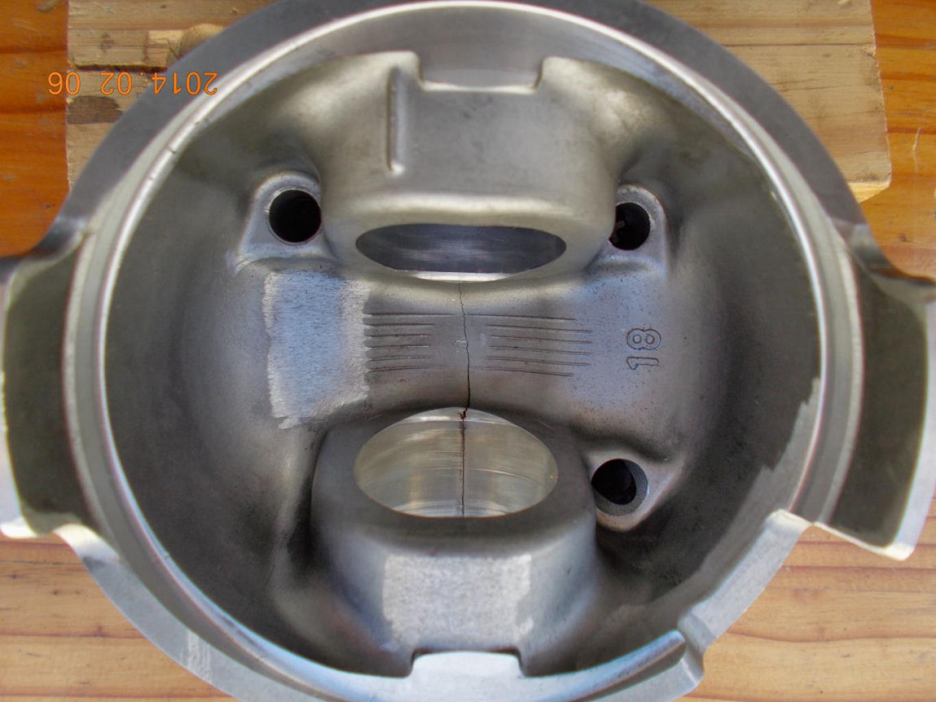

Having suffered a 'hole' in piston 2 of the Pajero, I extracted it with the motor still in the vehicle. The 'hole' turned out to be a crack running from the back towards the front, across about 3/4 of its diameter. Examining the piston carefully I found that two of the three manufactured holes that can be seen in the bottom view of the piston in Photo 1, run into some sort of cavity just below the piston's top surface. Furthemore, these holes are linked as proved with compressed air and the cable tie in Photo 3.
The best way to find what this strange (to me) structure was, was to complete the piston break-up by sawing with a hacksaw towards the crack through the remaining unbroken metal. The results are seen in Photo 2. The large black area shows that the crack had gone nearly all the way across the piston --- only the lower parts of the gudgeon pin sockets were still uncracked. Perhaps the crack had been developing for some time before the white exhaust smoke suddenly appeared in December. It seems that the crack finally burnt a hole through into the piston's 'cavity' (Photo 2) so discharging mixture directly from there into the crankcase. From there it would have gone via the timing chain cover into the tappet cover and through its breather into the clean air intake of the Turbo unit before emerging from the exhaust as white smoke.
Another very interesting feature shown by this cross-section is that the top compression ring and slot are tapered inward. Furthermore, the colour of the metal surrounding this ring is differrent from the rest of the piston. This difference is so uniform and regular, as seen also on the piston's surface, that it is clearly part of the manufacturing process --- quite a metallurgical achievement by Izumi! On the piston top there is the following identification: B, ME191470.

Photo 3: Cable tie through continuous cavity.
Photo 2: Cracked piston 2 cut in half.
Photo 1: Manufactured holes in pistom bottom.

I am no metallurgical expert, but I just wonder whether this is really a failure due to thermal stress caused by a leaky injector (per initial speculation), or whether it could not be caused by excessive clearance in the small end or big end, resulting in repetitive shock loads on the gudgeon pin area and then ultimately leading to fatigue.
I guess the casting design (cavity) is for reduced weight and improved cooling (lower mechanical and thermal inertia).

I don't think failure can be due to loose small-end bearings, for I was impressed with how beautifully new they looked and felt! I guess that I could also replace the con-rods without the pistons just to feel how much play there is, but the shells and journals look perfect!

I have little doubt that the failure was due to overheating, which could only have occurred due to over-fueling on that cylinder.
Have you had the injectors tested, especially that cylinder's one?

I have had all 4 injectors tested and reconditioned by Brandwacht Diesel & Turbo in Worcester who apparently have sophisticated equipment for this job. I asked if I should also have them check the injection pump and any other items that might be the cause of the piston cracking. I took the Turbo Charger unit to them too but, after looking into the input and output ports and turning the impeller with a finger, they said it was fine. They were adamant: the cause was due to overfuelling by the injectors, so I accepted that. I have also decided to replace all pistons and rings to try to avoid premature failure on future trips into the bundu.
