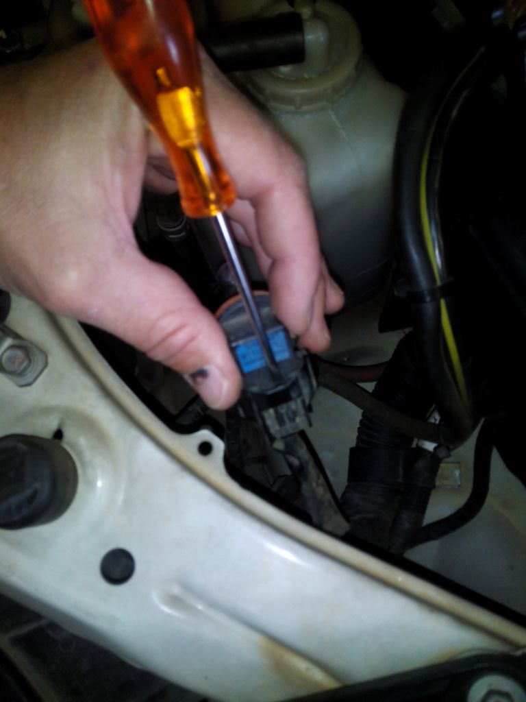

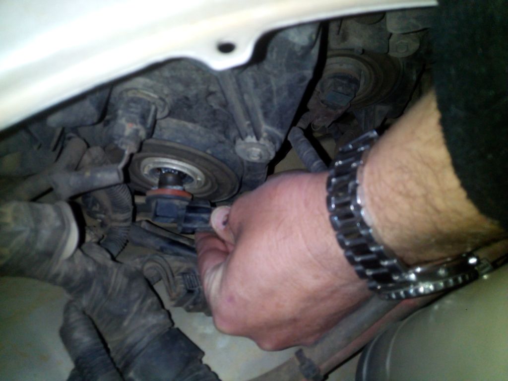

Both fittings are the same (different globe strengths though). low beam on the "inside" and the high on the "outside".
Turn the whole globe / plug anticlockwise and remove. Then, with a thin screwdriver you need to bend up a little tab holding the plug onto the globe. This you will find opposite to the globe itself.
Hope the pics help
