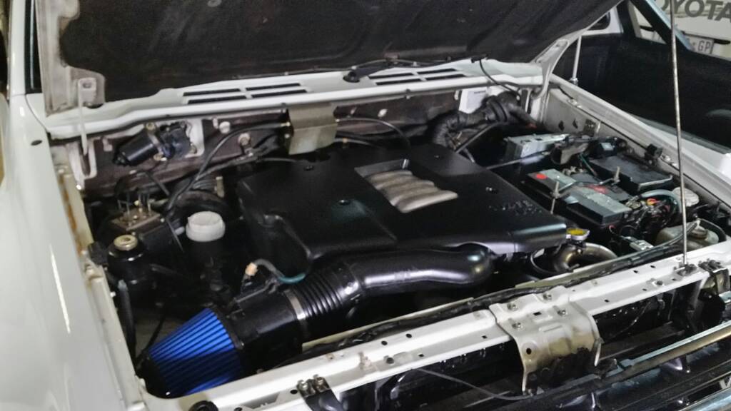

Today I finished my induction system for my air filter. Using the std Mitsubishi airbox (modded)
Wasn't happy with the idea of running a cone filter on dirt road
The v8 sounds alot better now when I plant her. Alot deaper growl
And I fitted a Opel power steering bottle.
Excellent choice - there is no way an oily cone filter is going to work in dusty/gravel conditions. If it turns out that your V8 sounds even better, consider it a perkPalexus wrote:Today I finished my induction system for my air filter. Using the std Mitsubishi airbox (modded)
PS what ECU did you fit?
