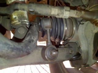

So I have this terrible squeek and it's off with the wheels last week just to find the two top balljoints have the rubbers damaged and I cannot get to the bottom ones nipples.
This is a question for another thread, back to the topic. I print this thread and take it with to Goede Hoop Spares. They showed me that my Pajeros suspension shares the same parts as that from the older square Colts. Buy 4 in PU rubber for R60 in blue nogal to match the car!!!
Now my problem, my suspension completely different to this thread :!:
What is this part called? I need to get them replaced. The one on the right is fine but the one on the left is bent and the top nut is loose so it will be a grinder job to remove.

They are called stabilizer links.

by jbeez
Thanx for the info. Only one left in the country, will try and source the right hand one from Japan. "Your car is old and spares is a problem" :(
