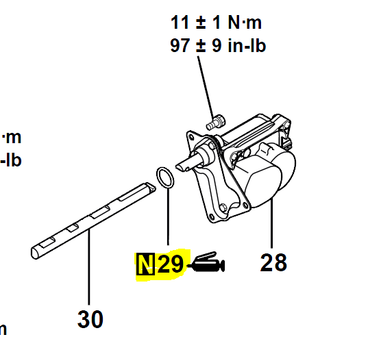

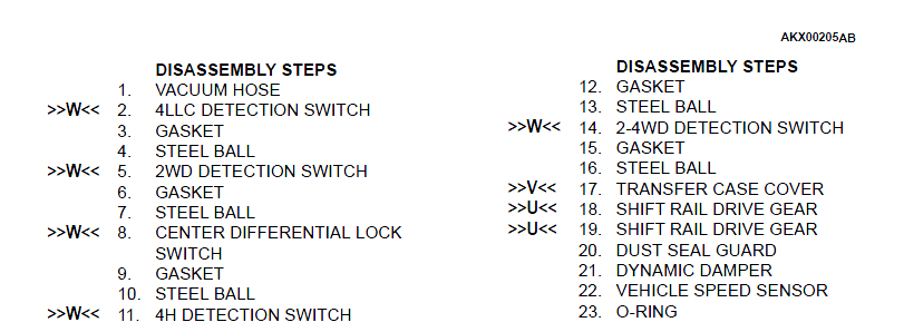

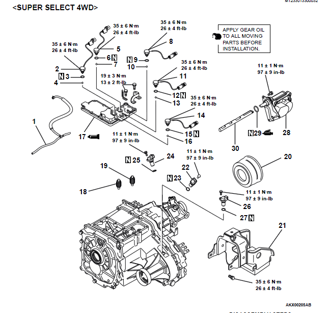

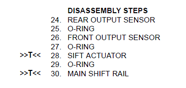

The manual for the transfer case is too large to up-load @ 12.5Mb in size. I have taken a screen shot of the actuator, it has a separate seal that is replaceable - part no 29 - 'O' ring.
Transfer case - exploded view
Actuator & 'O' ring
Actuator & 'O' ring

I am taking it in for a second opinion tomorrow morning. Not a paj expert but I am just looking for confirmation of where the leak is coming from. Dealer said its not the o-ring between actuator and T/Case, but would like confirmation.

Hi jamgrey.
I found it in the American 6g74 montero service manual, it is part 23B. For some reason that isn't included in the 4m41 service manual of 2001. The transfer case should be very similar though, if not identical to yours.
