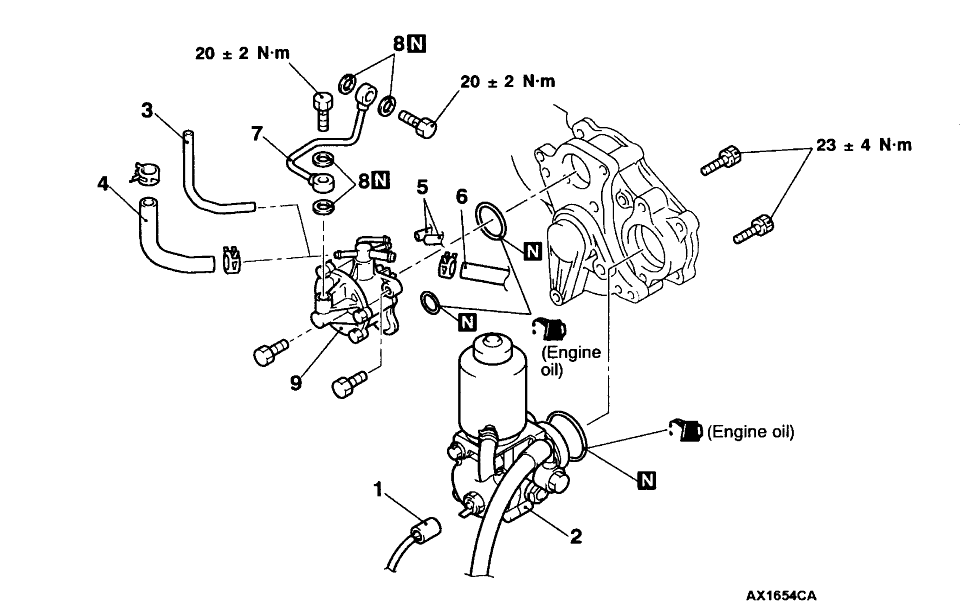

There is an "O" ring seal between the power steering pump and the aluminium timing case cover to which it is bolted. Order a new one and simply replace.LYCAN wrote:seems my power steering pump is leaking

I had a slight leak between the reservoir on-top the pump and the pump body, but a R3.90 "O" ring solved that problem for me.

The mechanic said that he did replace the "O" ring, but still leaking
Recommended to replace the pump

Had it checked out yesterday...pump is not leaking, might be a pipe
But then at the last moment the guy turns around and says it must be from the engine, engine oil stays at its level. Only power steeing that needs top up
