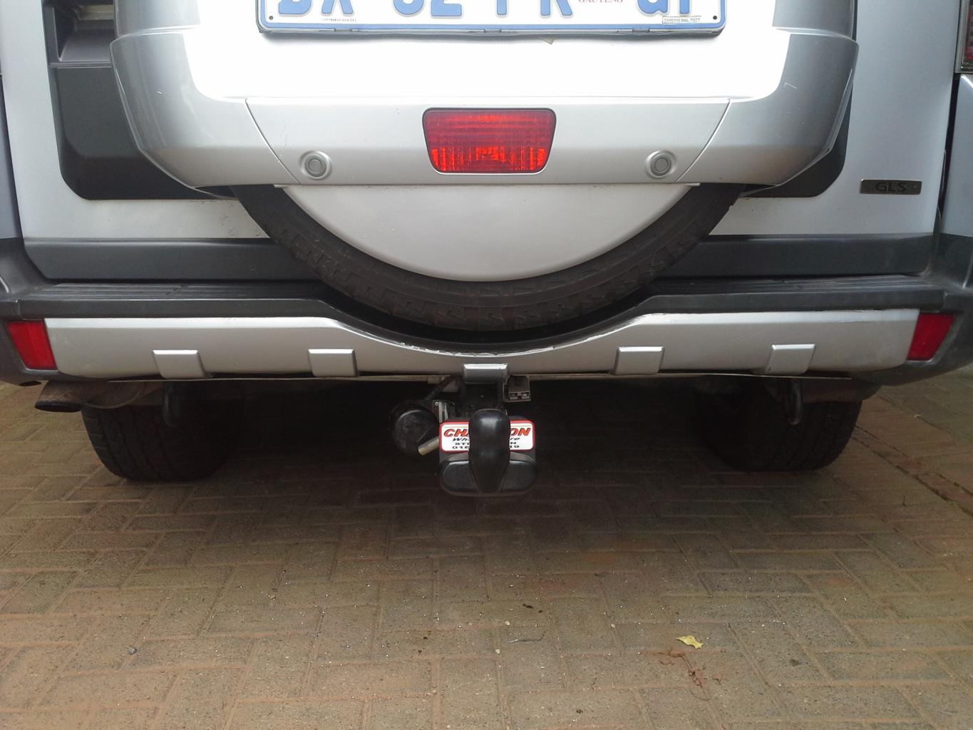

I am very happy with my Pajero but would like to fit steel front and rear bumpers. When I baught the car I was surprised to read that the rear bumper is scraping in the sand but I realised it is true when we did the Kgoarib river trail in April. The little spoilers on the front bumper had also to be removed. When we did the Three Provinces at Volksrust the rear bumper got damaged on a rock and that is after I have fitted an OME suspension that gave 40 mm lift.

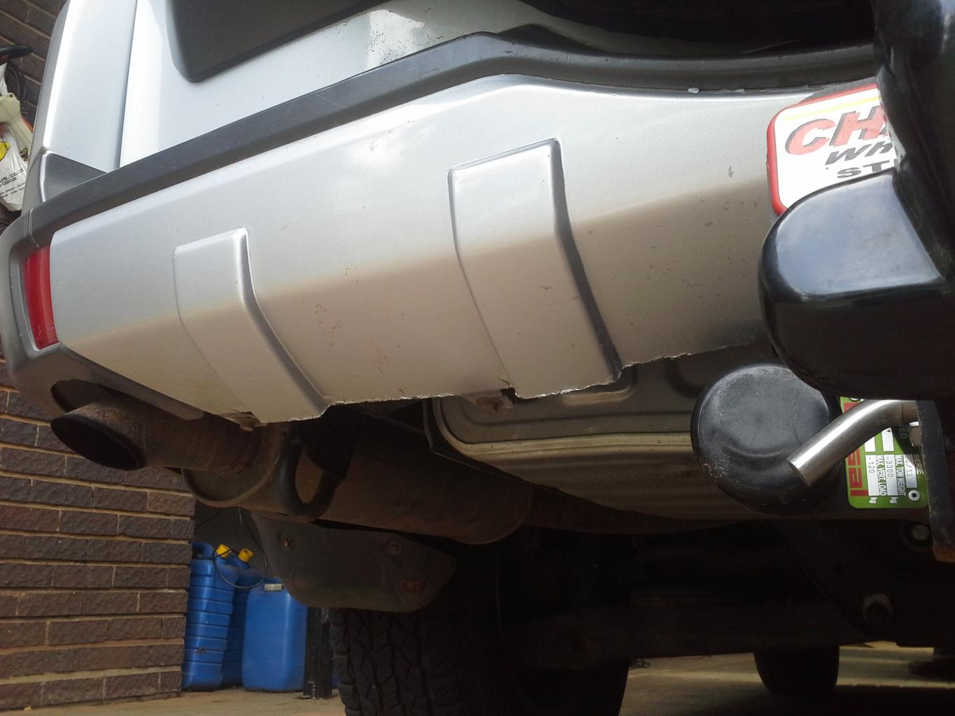

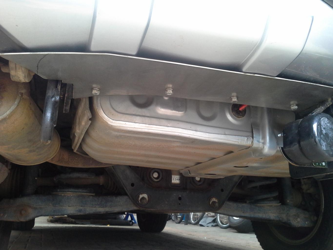

So thanks to some advice on this thread I made me some plates to nip and tuck my rear bumper. The corners are still a bit vulnerable but it's a huge improvement.
Mantovani,
It is a start but there are still places where rocks, sticks, etc can get hooked and pull the whole shebang off the Pajero.
With a little bit more plate (I recommend 2mm ally - easy to work with and not so heavy) you could have had a basically fool proof skid plate. Use a bigger piece and start at the rear suspension carrier. Attach with two bolts (the holes for attachment are there already - made by Mitsu).
Extend the plate to the sides and back and attach to the sides and rear of the plastic bumper with proper speed nuts and stainless bolts. By doing it this way the whole rear end is protected and being ally easy to repair with a 4lb hammer if it should get damaged.
Cloyd
