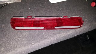

Hi solved a really annoying intermittent rattle coming from the rear of the car.
By luck I found it came from the top rear brake light lens cover (was going to sit in the boot while wife drove me round to find it). Fix was easy - some adhesive foam to make lens fit snug - happy camper, how I hate rattles.
