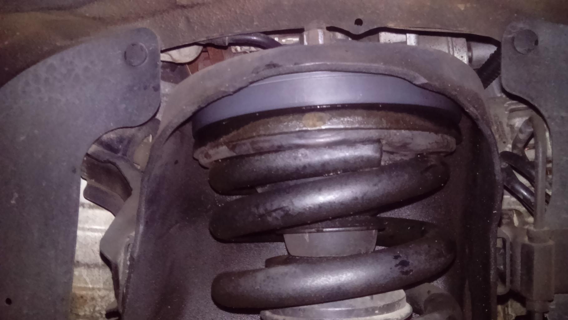

You can get 20 mm front spacers from stofpad 4x4 and the back ones you can make up from 30 mm thick nylon , I will see if I still have the dimensions have done mine by my self . and then I would suggest that you put airlift in as well at the back .

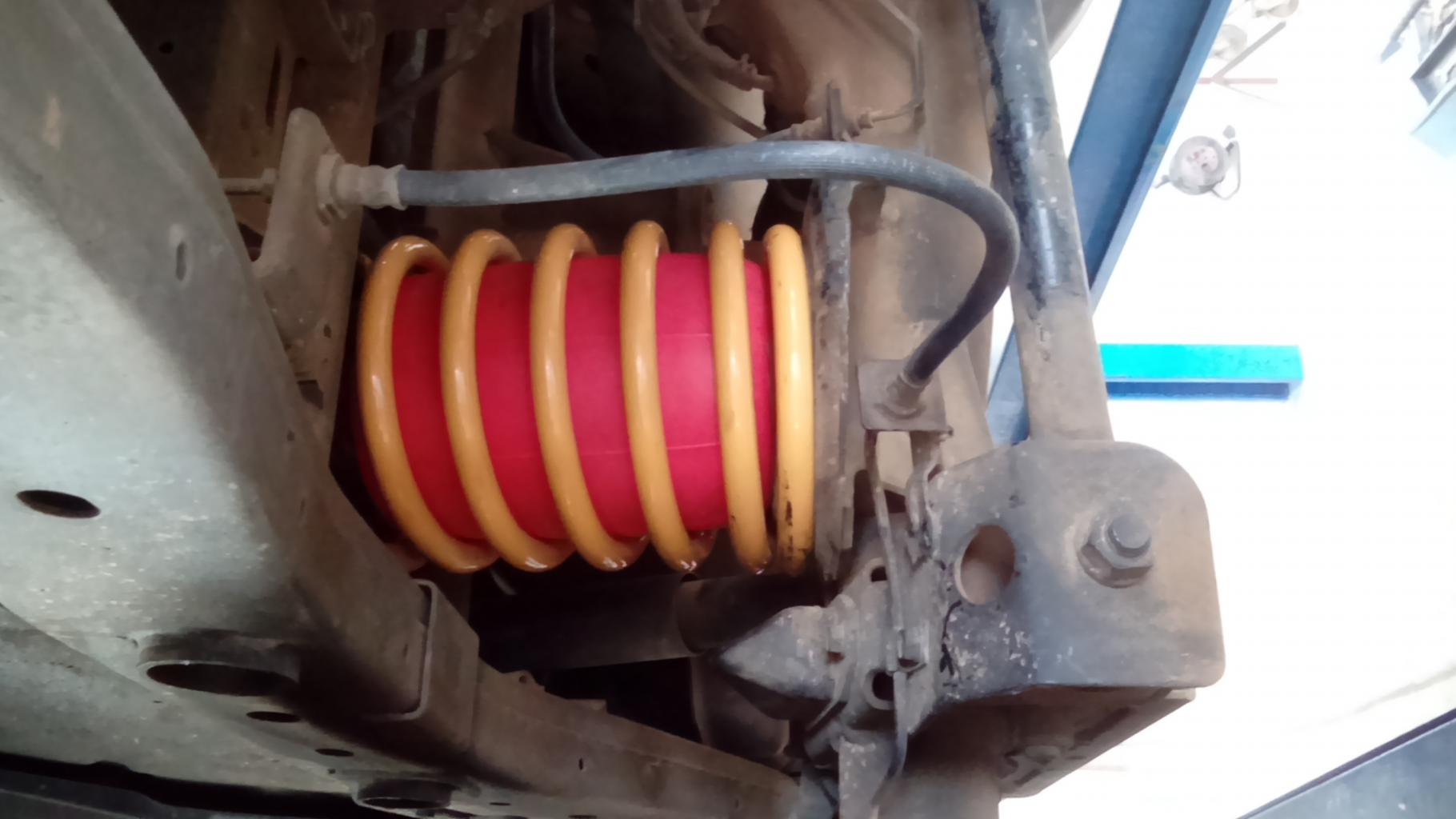

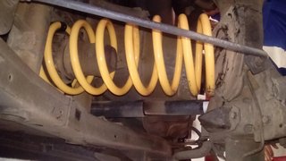

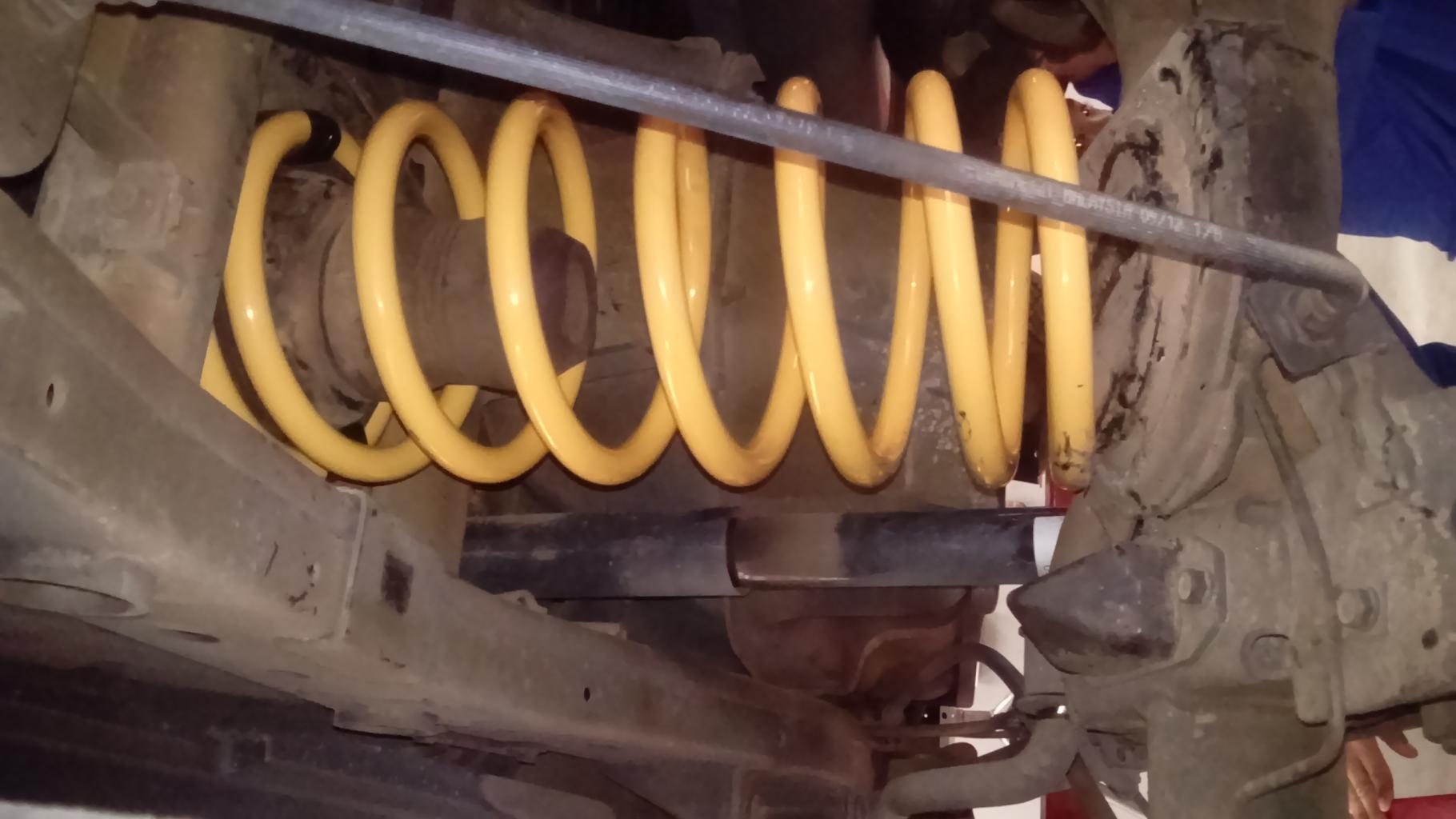

I have got 70 mm lift in front with 20mm spacers that's why I suggest to go 30 mm at the back to level out .Otherwise it will get expensive and you have to put Ironman or OME coils in like I had to do at the end and with the Ironman coils on a heavy load the coils bottom out .that's why I had to put bags in as well .
No I did not have to lengthen the brake lines , your shocks prevent that you don't have to much travel on the rear axel . I can help you if you are close to Paarl with the spacers and you can supply me with a 30mm peace off nylon cheat and then Speedy have spacers hear they do the hole thing for R1300 if you give them the back spacers ,the front ones they have . Or mail me at gielleam@gmail.com if you are not close by and I will sent you the dimensions off the back spacers and then a engineering shop can turn or cut it for you .
