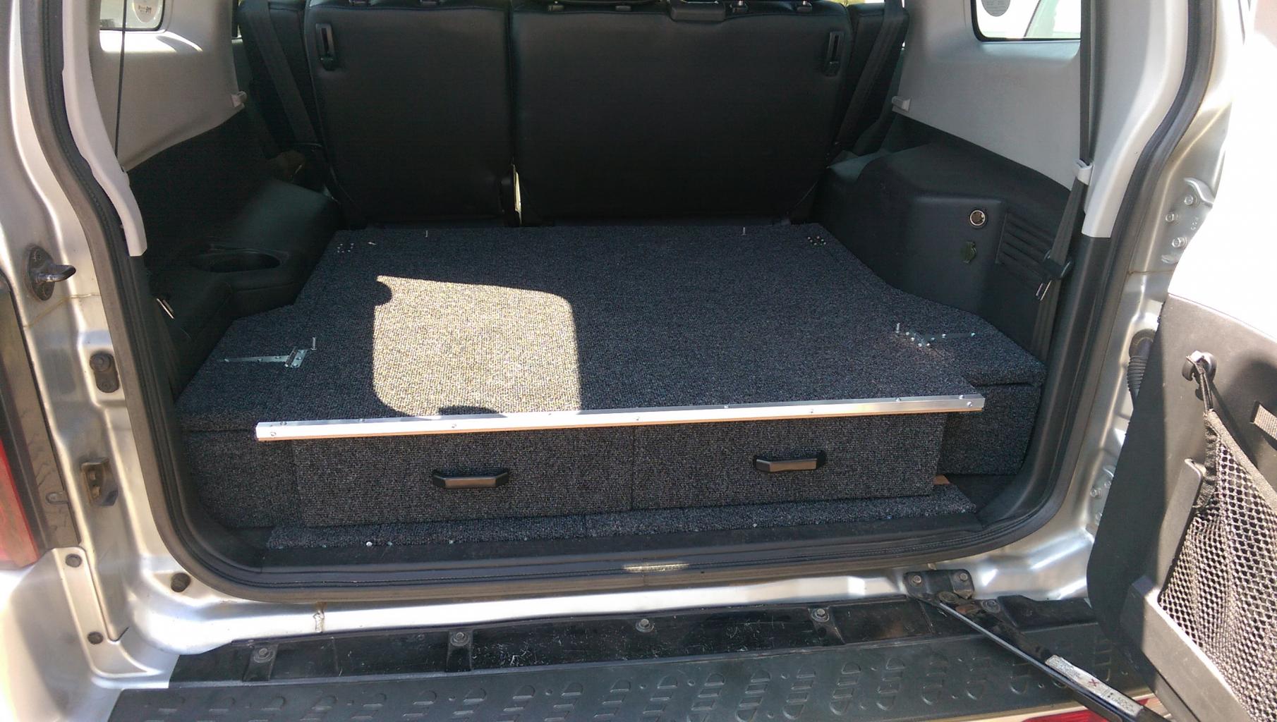

Here is a DIY Drawer System in my 2006 Gen 3.

Looks good - how high is it ?
It looks a lot lower than most drawers, which I think would be quite useful. especial if you have fridge etc mounted in the rear.
Can you still access the 3rd row of seats pocket ?

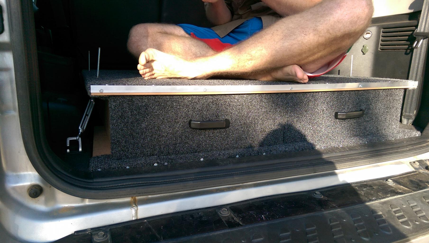

Did you build it using plywood or aliminium and connect-its?

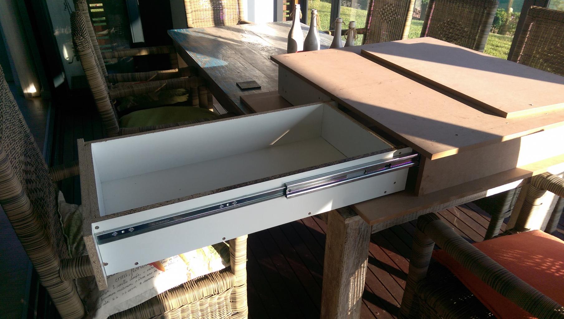

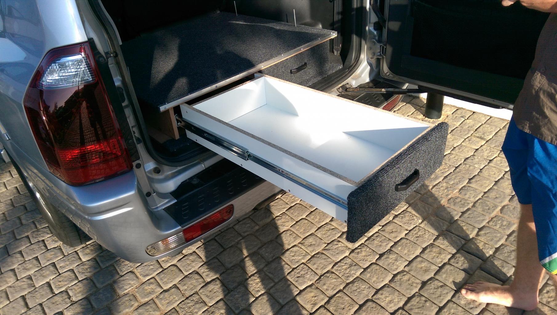

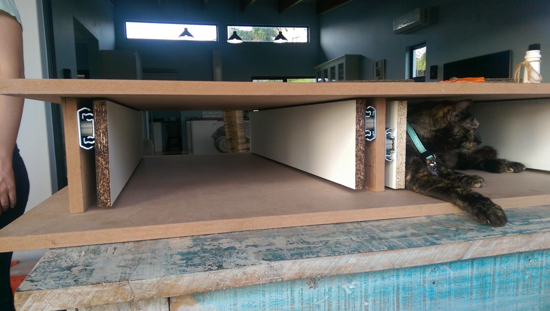

The inside of the drawer is 150mm high. Not big enough for a ammo box, but I wanted enough height to put a NL Weekender and still see out the back window.
Its made from Melamine (Draws) and Supawood (Frame).
I have removed the 3rd row of seats and used that area to store odd's and ends. I can remove the back of the draws to get access to this storage space.

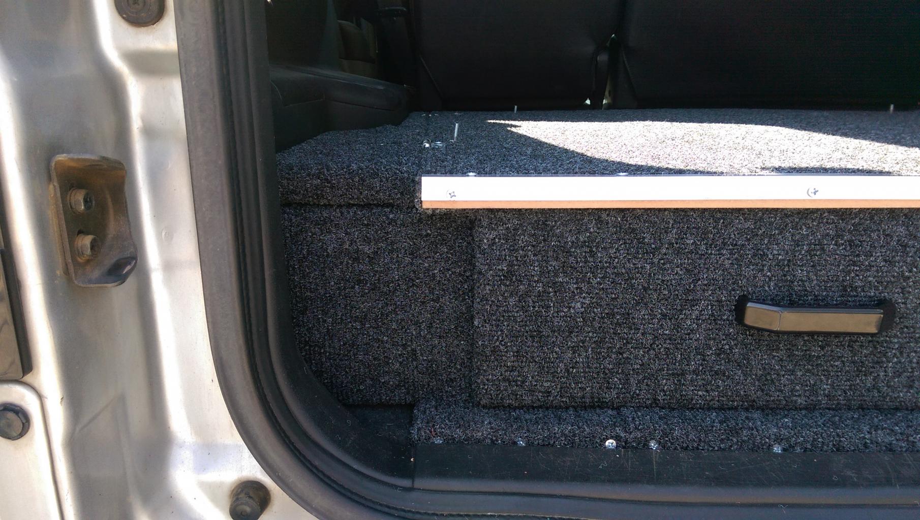

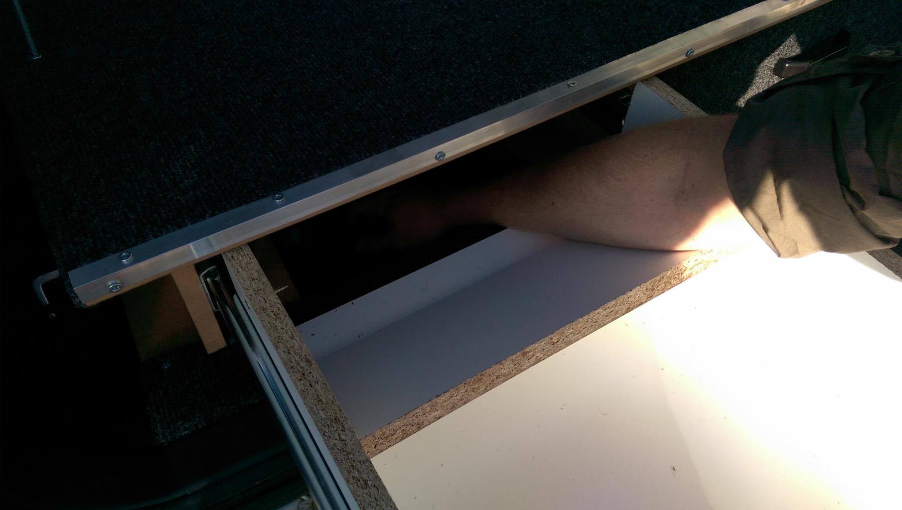

I think the drawer in the 3rd pic needs to be decatted to work properly.
Well done. Looks really good and still being able to access the 3rd row seats area is top notch .
Re: Gen 3 DIY Drawer System
MThompson wrote:I think the drawer in the 3rd pic needs to be decatted to work properly.
For a moment there you had me! Image But then I rechecked the photos, and I agree. Decatting needed indeed Image
