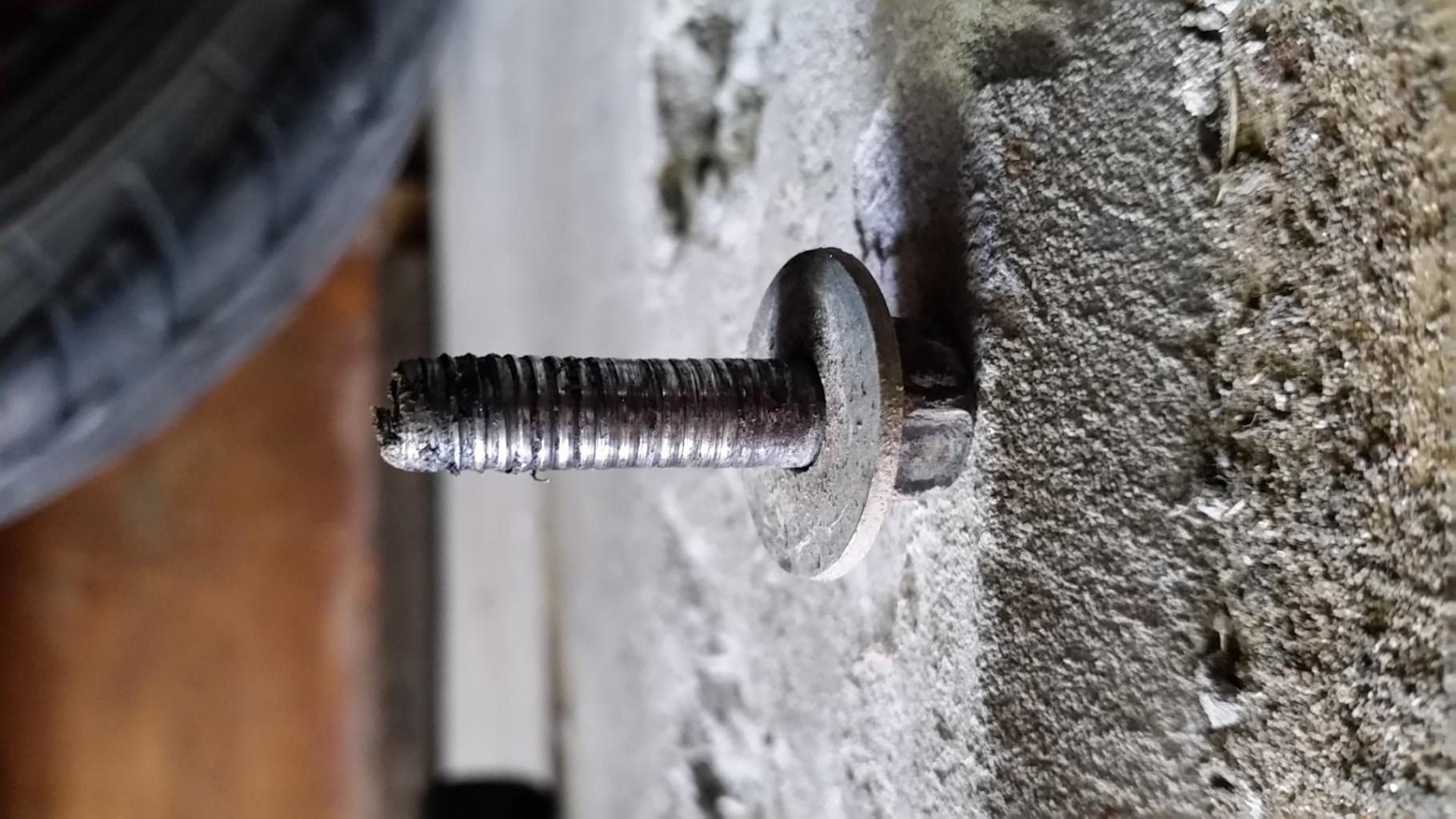

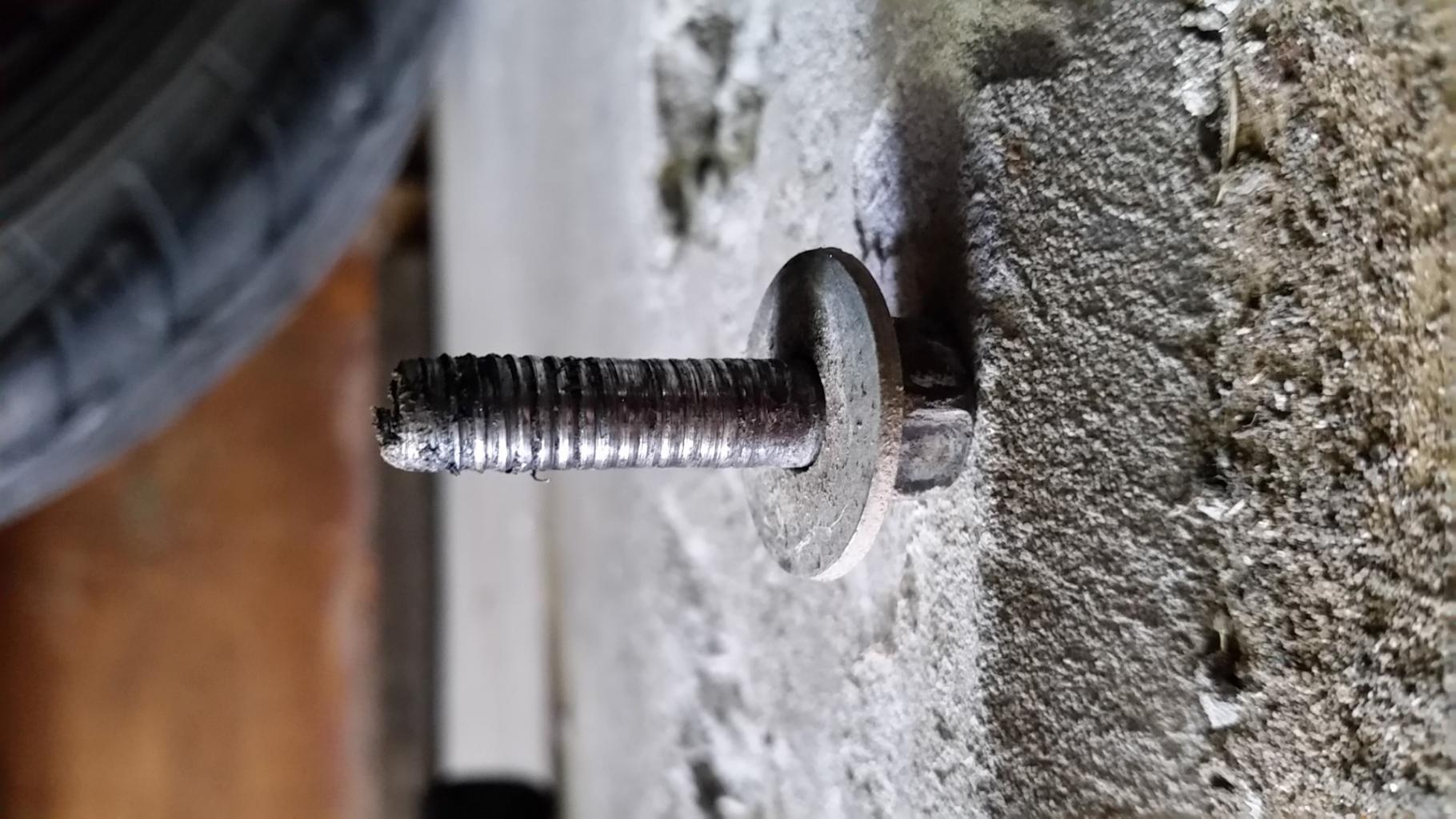

Here is one of the bolts - who does this ? :

Are you sure these are the same bolts that you fitted when you fitted the bashplate? Why I ask is that the thread is damaged from the tip all the way up to the washer. Are they all damaged in exactly the same way?
The most likely to have happened is a) that when the mechanic tightened the bolts he over tightened and stripped the thread. Note thread from middle towards head seems less than from middle to point (this could also be influenced by a lower quality / tensile bolt), or b) (less likely) that a bolt with an incorrect /non matching thread was used. It normally happens when a bolt /s is /are mislaid and an incorrect thread is then used as a replacement. This is difficult to determine though without seeing them all.
What also happens is that when the bolt is too long and on exiting the other side of the thread fowls something and gets damaged. The "mechanic" then removes the bolt and on exiting, the damaged bolt damages the thread. On replacing / fitting the part again, the "mechanic" then swops the bolts around and now you have two damaged bolts and two damaged threads.
Unfortunately these days the quality of workmanship, skill, training and pride in workmanship is sadly lacking.

Thanks for all replies - agreed baffling how they got so damaged.
Spend an hour at the dealer and managed to be part of the repair to make sure it wasnt stuffed up further - 2 stuck bolts we got out with tyre leaver and air gun (socket rotation speed was too slow)
We then cleaned up the thread and did visual inspection - I am satisfied that the tread is mostly intact so damage was fortunately concentrated on the bolts - I am wondering if the plate wasn't skew so when the last guy put them in, the tread was rubbing against the bash plate before entering the hole - thus destroying the thread along its length before it entered the captive nut - all I can think of.
Bolts were correct length and correct thread - they definitely the Mitsu ones I bought with captive washers.
So all good until next appy comes along I guess. ;)
