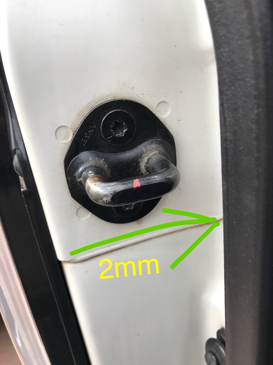

Although it could be the seal due to age, try adjust this latch about 2mm “inwards”. Simply loosen those two funny screws enough to allow the latch to move by tapping with a hammer lightly. The latch only needs about 2mm forward movement to allow the door to close a little tighter.
If you move it too much then the door will be very difficult to close and open. Give it a try and see if that helps.

KurtG wrote: ↑Sun Feb 11, 2018 8:21 am Hello saltydog.
Give that man a bells. You sir have helped save my sanity.

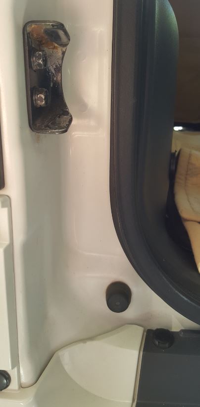

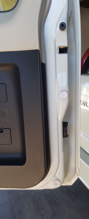

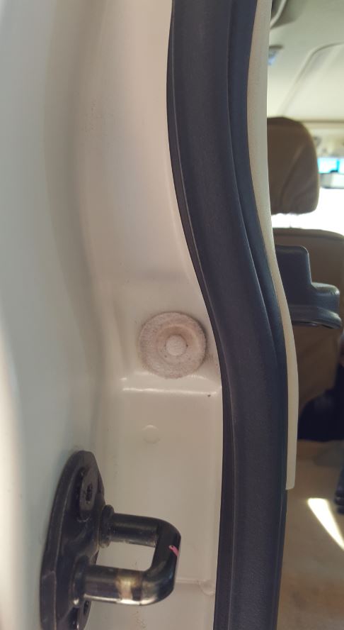

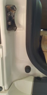

I also experienced the squeaky rear door and after trying everything, I found that the squeaking is actually cause by the the little round rubbers on the door.
I stuck felt floor protectors (for furniture legs) opposite each rubber and.....no more squeaks......
Observe the small white circles on the door and frame.......

2015 3.2 DiD GLS SWB - Acquired Oct 2015 currently on 40,000kms
2002 3.2 DiD GLS SWB - Acquired Jan 2013 on 297,000kms (sold Dec 2016)
