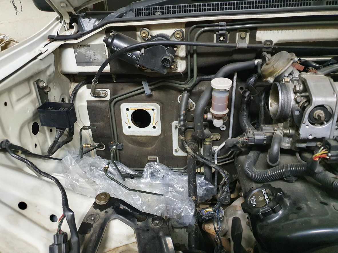

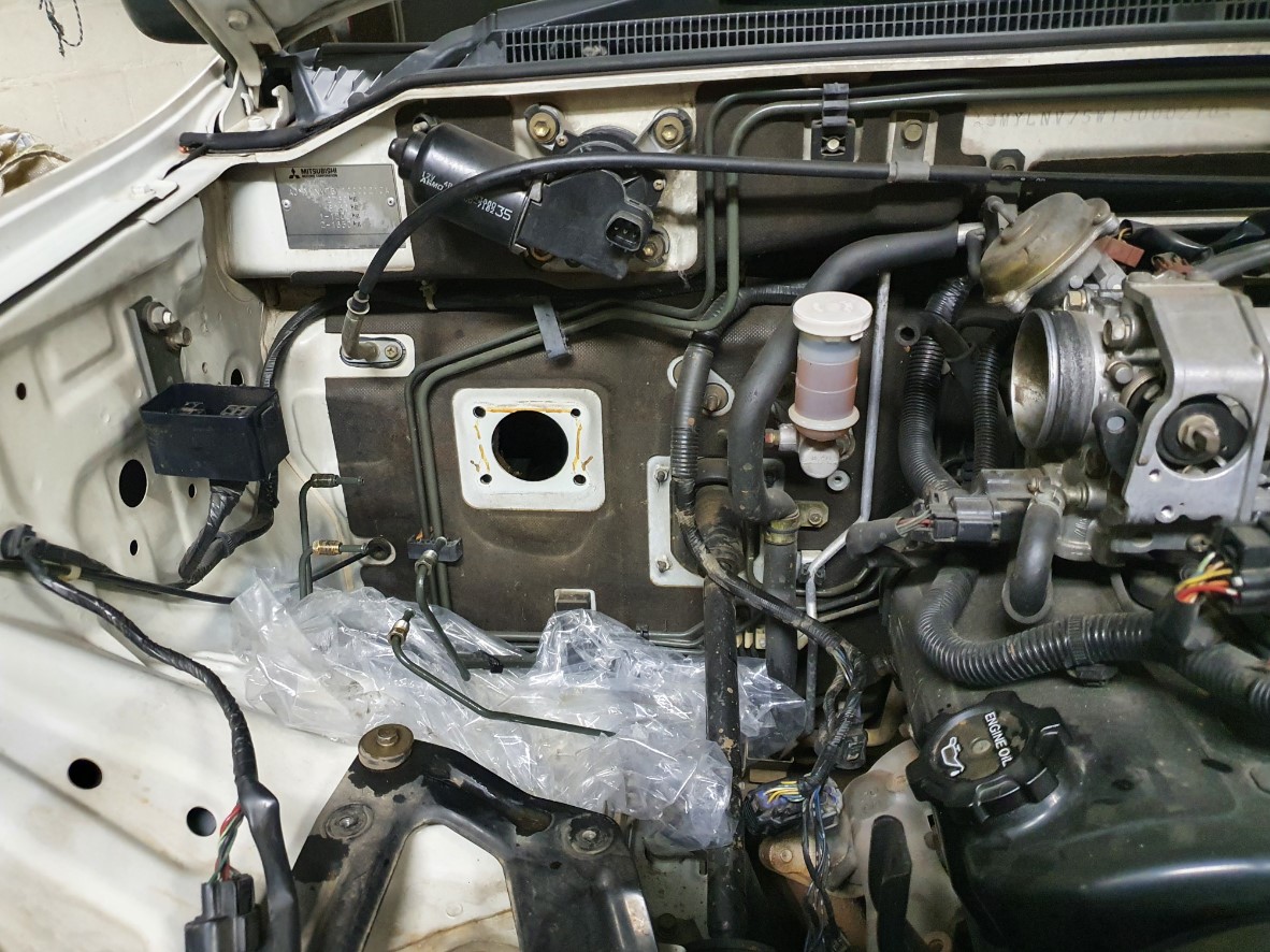

I had the same problem in Cape Town and was solved quite easily (after overcoming the horror of a hearing the new OEM part is R38k). The ABS pump's other name is the HBB unit pump (Hydraulic Brake Booster Pump).
There is a rewinder in Klapmuts in Cape Town that keeps the commutators of the little motor on the HBB in stock. (Kasper +27 82 782 1884). Your alternative is to order a complete new armature from Italy, or the complete motor also from Italy on eBay. But at ~R1800 and some elbow grease I was happy. After some calculations on import duties and other costs, the repair option was by far the easiest, fastest and cheapest solution.
The link and Post above in 4x4 community is a good layout / description of what they look like. Apparently, it is the same Aisin HBB unit as that what is found in the Landcruisers. On mine the brake light came on and pretty much you have 1-2 km to find a safe spot to stop, because then the brakes become so hard you cant brake anymore. The little motor driving the hydraulics does a lot of work to help you to brake. I have however seen the Africa imported basic spec Pajeros have a normal Brake booster in, but I think they don't have the same towing capacity as brakes with HBB.

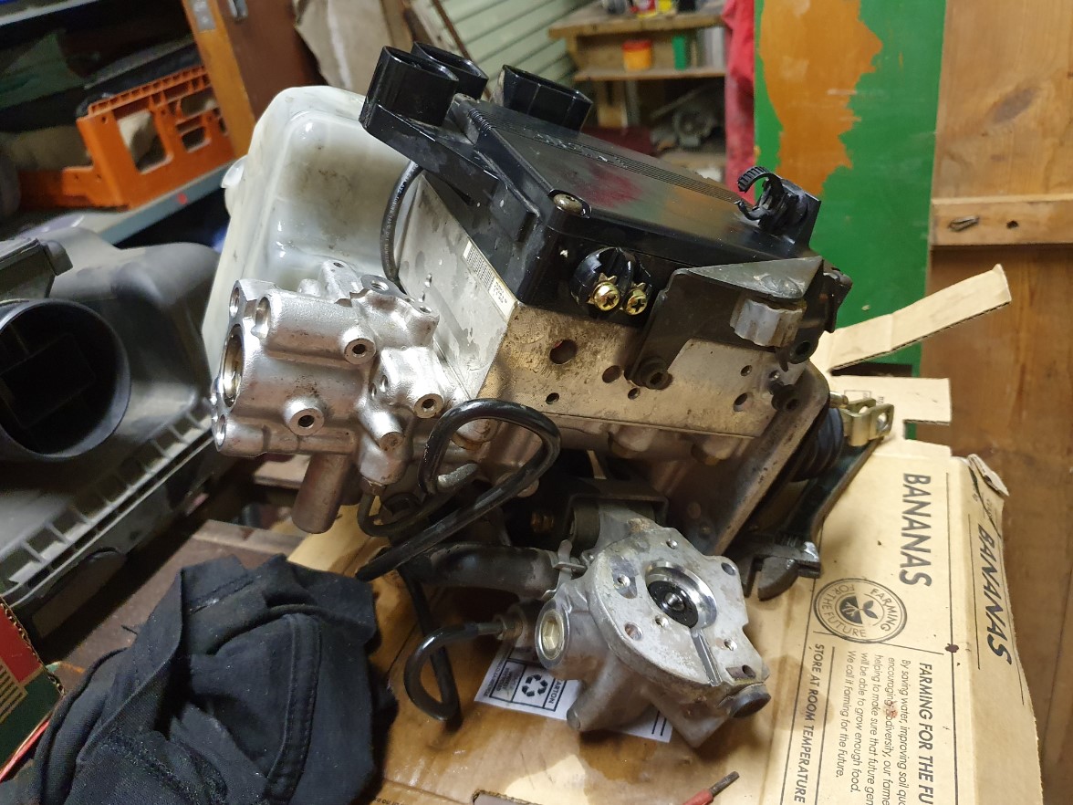

Removing the pump was easy, just be sure to get a nice piece of clear plastic bag in underneath the HBB unit to prevent the Hydraulic fluid from damaging your paint. Do not reuse the same brake fluid that you remove. Buy 2 x 500ml new fluid.
You have to remove the whole HBB unit, as the motor bolts are not accessible in-situ. It also has small drive coupling that would be impossible to get back with the HBB unit in place.
Also, just remove the Air-cleaner box and pipes first. (otherwise your will struggle.) The Main pin and spring clip linking the brake booster to the brake peddle below the dash and 4 small nuts is your last difficulty (difficult to twist your body under the dash to get to them. Remove the driver seat for easier access. It is actually quite quick to remove.
Putting it back goes fairly quick. the biggest pain is the pipes that get stuck and hook onto everything you trying to squeeze past. You should take a couple of pictures before stripping. BE VERY careful to turn in the hydraulic couplers into the HBB unit straight. If you cross thread them, you are in for BIG money.
Once all assembled and running you can fill the reservoir and bleed the brakes.
I bled the brakes starting from the furthest wheel and ended with the closest tot he HBB unit. (Start bleeding without the main engine running. - Ignition off). The brakes are very hard then. I think the ABS only works on the front wheels, because we were able to bleed only bleed the rear effectively like this.
Then switch on the ignition and start the pump. (no engine running). ...Listen to that sweet sound of the motor running.. Wait for the pump to complete its first run cycle and stop. Repeat the bleed process with the ignition on. Bleed from furthest to closest again. Then you can drive slowly and find a open & safe gravel road.
You then drive and repeatedly brake hard, so that the ABS kicks in and you feel ABS kicking in consistently. I did this 10-15 times, until I was happy the brakes and ABS works fine again.

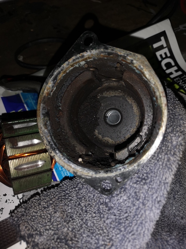

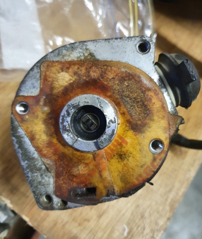

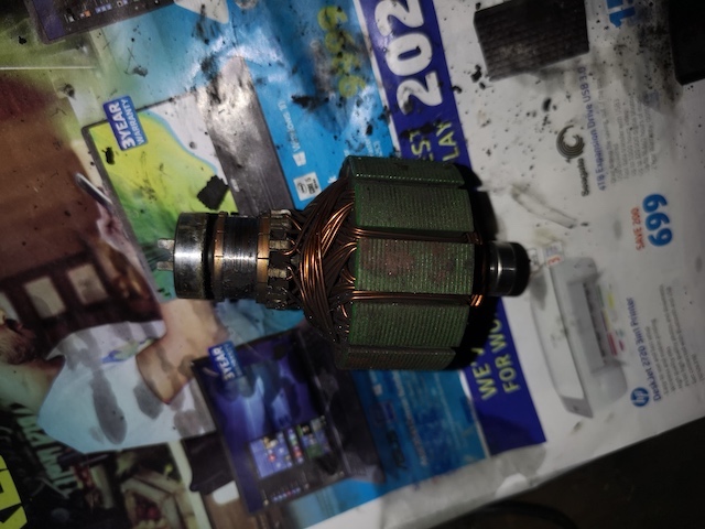

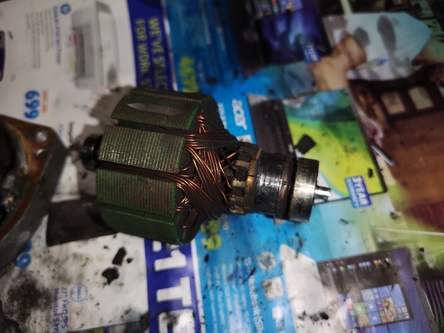

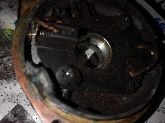

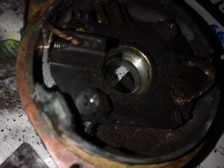

Took the unit off, removed the motor and opened it. As you can see by the pictures, the copper contact sections are warn away - I would imagine it worked sometimes, if it was on a piece of copper and then would spin as the momentum would help moving it.
My thought it to take the rotating stator part from my motor which is still ok and insert it into this motor housing and magnets.
My motor where they re-epoxied the magnets, I am thinking that they may have replaced the magnets and also maybe the positioning of the magnets is not as per the original and that is why it did not run properly.

Yip, looking at the condition of your motor's inside, I think its where your problems are.
The commutator should be nice and clean colour copper. Black segments may mean the copper has been worn away. You should measure the resistance between 180 deg opposite segments. Then advance one segment at a time an measure to the opposite one. All ohm readings should read the same. If they read much different, you should have the ccummutator replaced.
MMC 3.5 V6
Country: ZA
Vehicle: 2000 Pajero 3.5 V6
Location: Kuilsrivier, Kaapstad
Posts: 51
Joined: Wed Jan 18, 2012 4:02 pm
Re: ABS pump
Sat Jan 30, 2021 9:40 pm
The commutator should be nice an cleand clean copper. You should measure the resistance between 180 deg opposite segments. Then advance one segment at a time an measure to the opposite one. All ohm readings should read the same.
Your commutator segments seem completely worn away. I see only black and no separation where the copper should be and the insulation inbetween. Replace.

Thanks MMC - Going to put the best of two motors together today and see the outcome. The brushes on the motor with the segments missing are very worn, so I might use the front plate from my motor as well.
