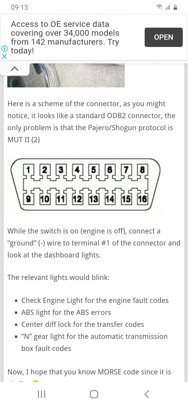

HI guys bought scanner for my Pajero. Unfortunately it dosen't communicate as Pajero uses MUT 2 although same connection. Has anyone found one that's functional with the Pajero. Or is it not a problem with later ones mines a 2001/2. As the athacment says ground term one observe the relevant lights to diagnose.

Hi Dirty Dog,
Re the scanners glad yours working good. I also got from Takealot Konnwei KW850 so not the basic scanner. It came up unable to communicate. Tested on my Ford worked. Did more research mines a Gen 3 2002 model 3.5 petrol GDI ex UK. Found it uses a different communications platform. Mitsubishi refer to it as MUT - 11. Not sure if that's just their trade name.
