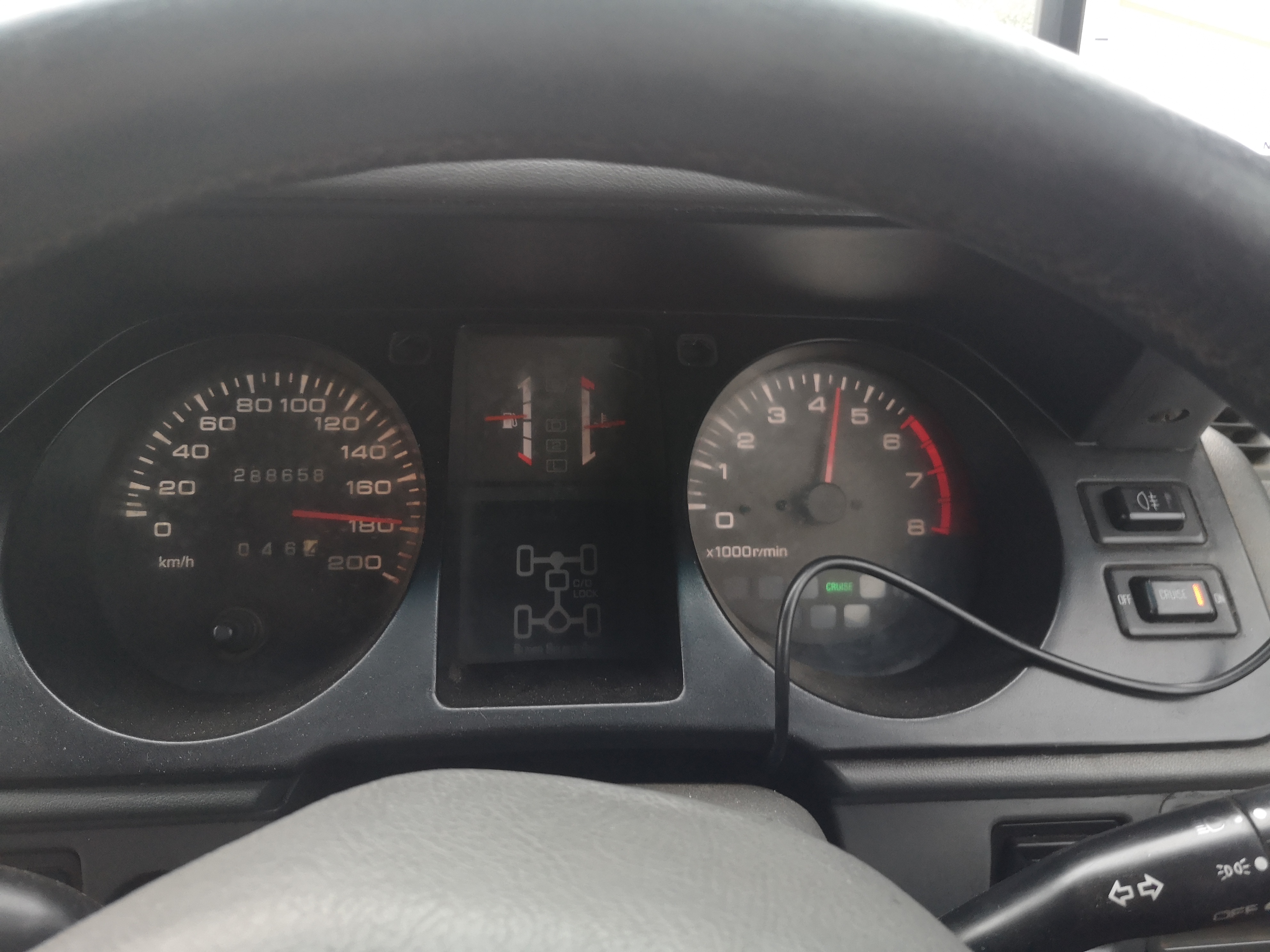

It had a vibration at 130, so i drove 150. 9th of Dec 2019 we went on holiday to cape town, my true love, we stay in Witbank Mpumalanga, my enemy. We had a extended venter trailer fully loaded and 6 adults and my, at the time 1 year old daughter. That thing did not even feel the weight. Cruise control 150 and off we flew. So not care about consumption because it is non existent at 5.5 km per L, no matter how you drive, No problem, i did not buy it for fuel saving.

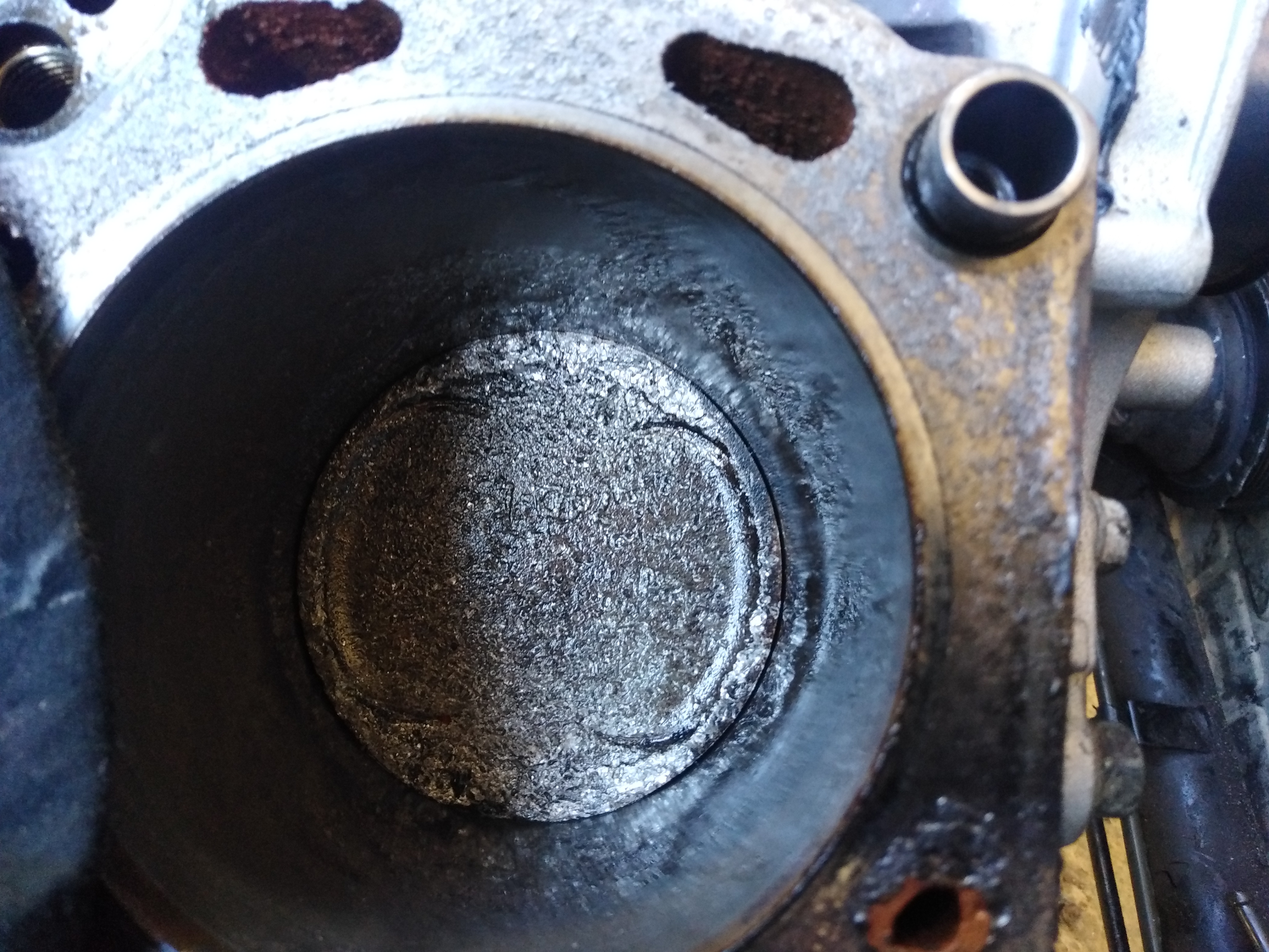

I stripped the intake of and did a compression test,
No1 and 6 Cylinder NO compression.
Removed the cylinder heads, valves bend on no 1and 6 cylinder, and no 1 piston had chip marks all over this piston, like something, GRRRRRRR, dancing on top of this piston. No 6 had something funny cone shaped lodge between the valve and seat. keeping the valve open but also bend it slightly.

Tell me you where not doing that speed, towing and fully loaded with people, in the picture ?, it sounds like a wind-up, If not, you are way braver than me.
