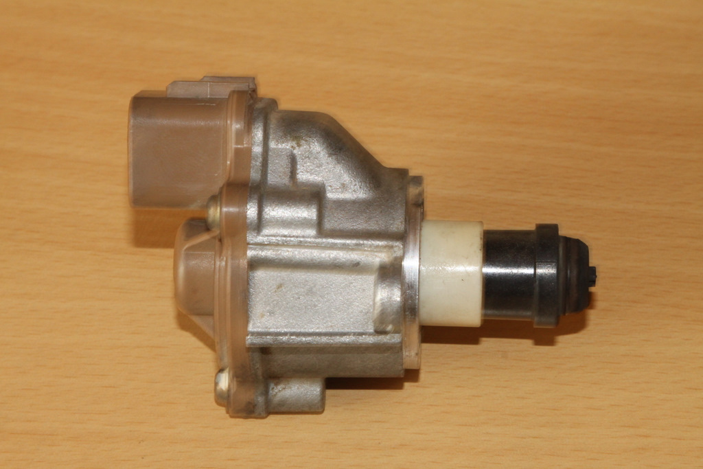

Well I promised a short write up. So, here goes...
Replacing the ICV is easier than brushing your teeth, although if the price to weight ratio was anything to go by, an ICV is about as valuable as gold, and probably closer to the price of platinum. This is what the ICV look like:
First things first, the symptoms of a faulty Idle Control Valve include:
  • The vehicle starts but stalls immediately without a cough or splutter - it just dies.
  • At full lock on the steering the vehicle will stall or labour a lot.
  • If you switch the aircon on the vehicle will probably stall. If it does not the revs drop when they should increase about 200rpm when the compressor kicks in.
You can go through the exercise of metering the ICV to check it's operation, but it's probably quicker to swap out a functional one. Whether it works or not is obvious.
On the 3.5V6 the ICV is secured by 2 screws immediately underneath the air intake into the throttle body.
Unscrew the 2 screws on either side of the ICV, although you might need an 8mm spanner to loosen them. Unplug the harness, and install the new ICV in reverse order.
Having replaced the ICV you might find the vehicle idles far too high, especially if you've been running without one, like me, for the better part of a year (something I DO NOT recommend if you do any regular offroading). It's a simple matter of setting the engine idle speed which is a screw located at the back of the throttle body closest to the firewall, under a rubber plug.
You'll need to readjust the idle speed to around 700 to 800 rpm. If, after you have cranked the idle all the way down, it still idles high, then there are other steps to follow including the SAS, but I have it on authority the ECU will readjust the idle to the right level given a few days of driving. As mine is sitting around 1000 rpm I have decided to leave it. This is because , when the idle was adjusted to nearly 1000rpm while I was waiting for a spare ICV, I noticed it settled back to 750-odd rpm as a result of the ECU "learning" the correct settings. I am assuming it will do the same with a functional ICV.
Short, sweet and simple.
BTW, there are many comments on the various SA 4x4 forums that Mitsubishi engines are not able to have the idle speed adjusted. This is completely false and anyone who takes more than a few minutes to peruse the workshop manuals will see this.
Happy offroading...
