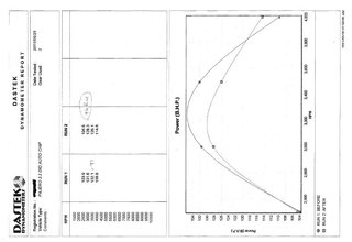

This is dyno results at Dastek themselves some time ago. It was for a 2003 LWB 3.2 DID a/t.
I bought a used plug and play Dastek unichip and fitted it to my Pajero. Dastek detuned it slightly because it was to rich.
Dyno results on Pajero DID

Further to my post above, deon.vhd's post exactly illustrates the point I was making.
A Gen3 3.2 DiD will produce somewhere around 70 - 75kW on a dyno at the wheels (which is the only measurement that a dyno can actually do). I guess a Gen4 maybe 85 - 90kW. DASTEK (or their dyno suppier) have then programmed in a fudge factor to estimate a conversion from kW at the wheels to kW at the flywheel.
EXCEPT for comparative purposes (which can be very useful when trying to tweak a chip) I would maintain that the absolute values shown on the chart are meaningless.
