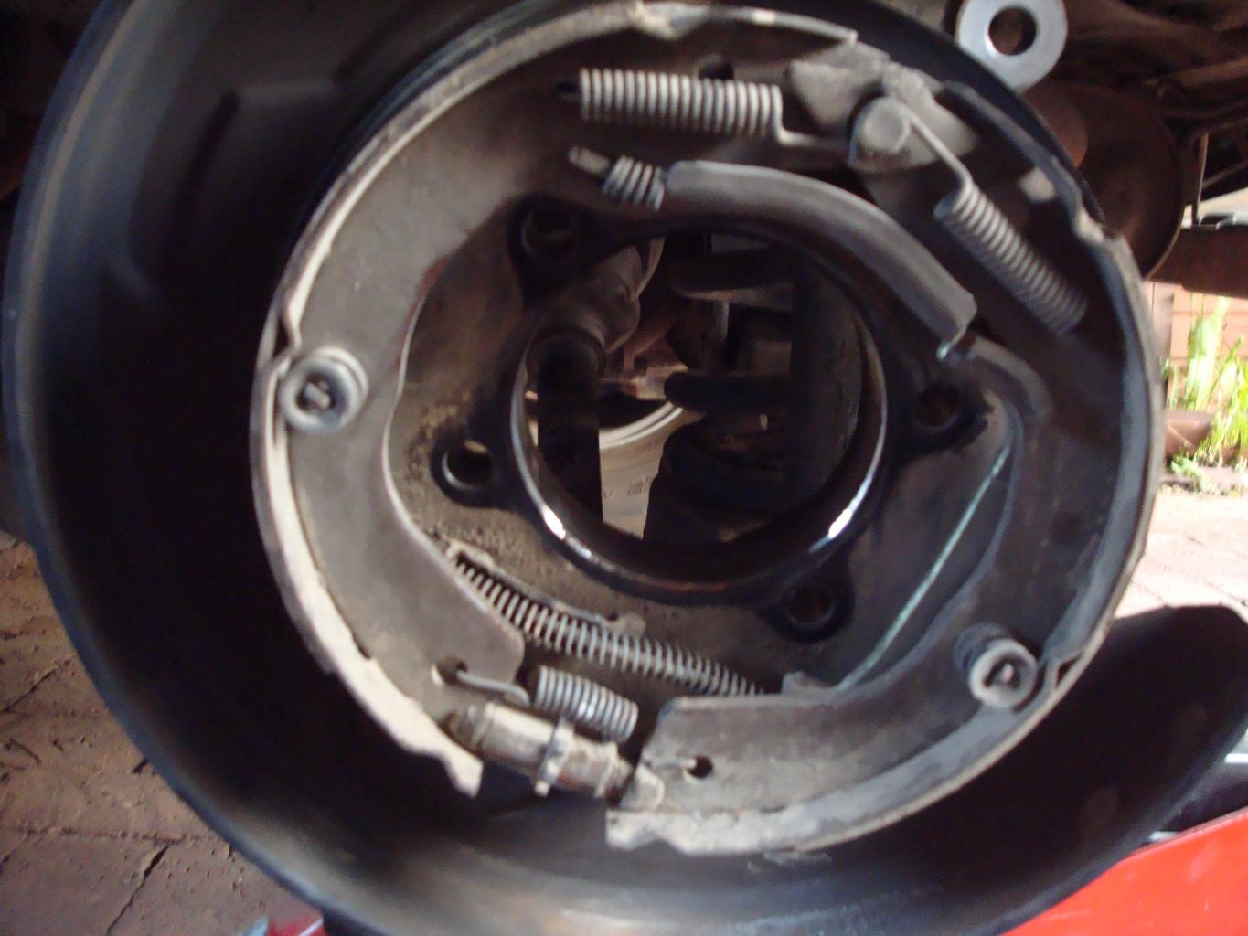

Have replaced the front and rear wheel bearings the other day, some pics below:

I replaced all the bearings because one failed catastoriphically, which left me in a ditch on a Sunday in Soekfontein. I did not want to worry about another situatioin like that so replaced all of them.
Depending on the model however, it is not as simple as a couple of loose bearings at R750 plus each, as my model and up has a complete bearing/hub assembly as per the images in my post. Those come in at about R2500 each, depending on if front or rear, as the prices do differ.
