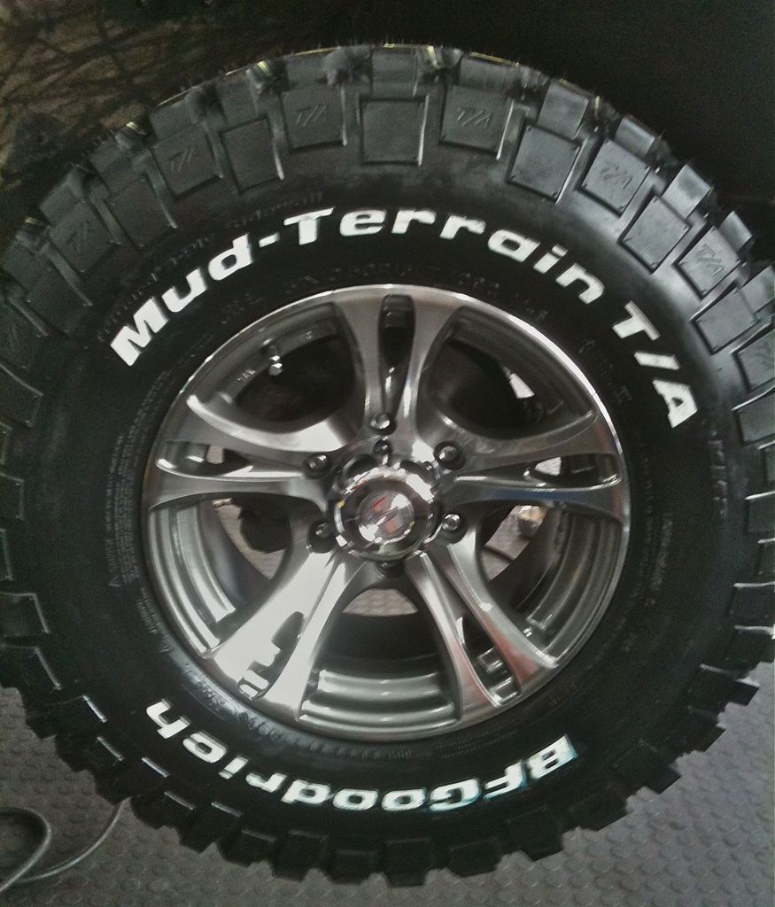

Fitted some new tyres

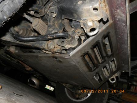

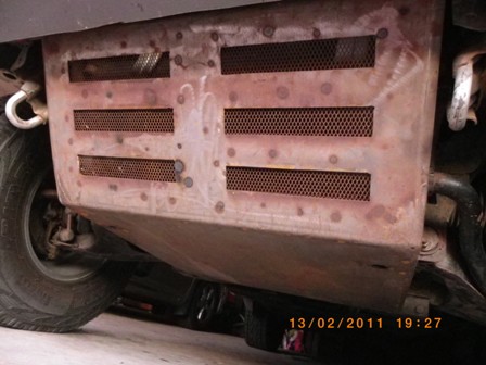

Home made bash plate. Needed for first off road outing
First bolt on
First bolt on
Just need to be galvanized and 2 more gussets added
Ready for galvanizing

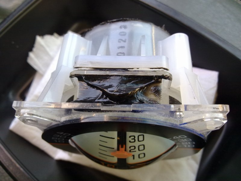

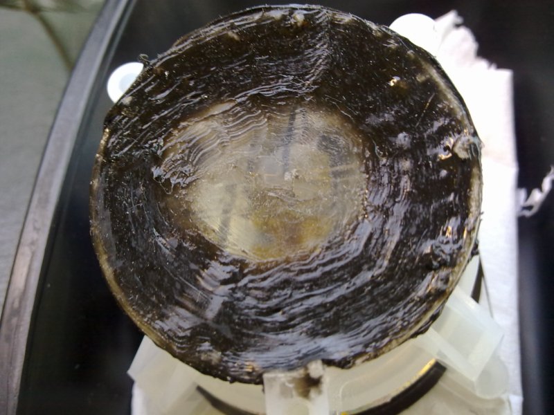

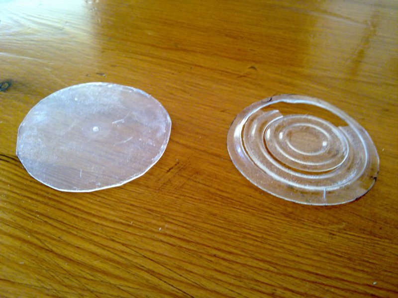

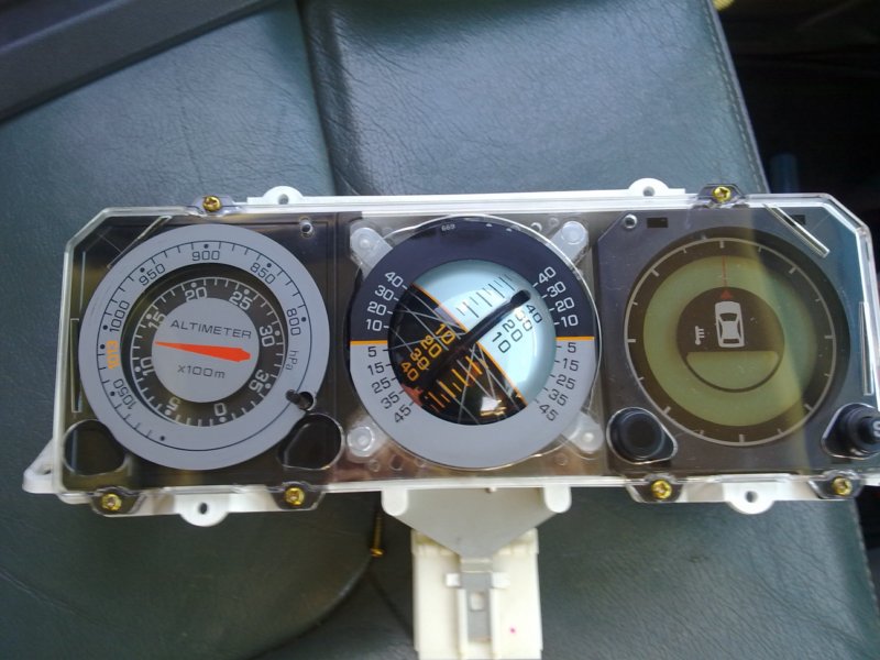

I have recently found that the liquid was leaking out of my car's inclinometer (omdondermeter).
I saw this link: Fixing the Inclinometer, and decided to give it a bash.
After removing it, I found that the inclinometer has a flimsy / cheap plastic back cover that started to disintegrate and leaked.
I removed the back plate, and replaced it with a more hardy plastic disk, glued it (superglue) and sealed it (silicon).
I removed the (old) seal on the drain/fill hole, filled it with fresh "mineral oil" (used normal baby oil - so it will smell better if it breaks again!), glued the plug back, and also sealed that with silicon - wala - it worked.
Guage-cluster removed
The new backplate (left) and the old flimsy one (right)
Backplate replaced and sealed
drain / fill plug sealed after refilled with mineral oil (baby oil)
I must say that, when we tackled the dunes on Sunday, I have newer even looked at this guage - too busy negotiating the sand - so I guess it is a cool trimming at best...
Hi Anton
I agree with you, that that gauge/s are not practical, at most times. You cannot afford to take your eyes of the ground ahead (as a few of us found out the harsh way, on Sundays do).
I've already bought the replacement gauges (volt meter / 2nd water temp gauge / oil pressure gauge), as has proven a good idea in the SWB, for the LWB.
Most of the GPS'S (I'd imagine), have a built in compass (more accurate - even my cell has a good one). :roll:
One's eyes and common sense should suffice for the inclinations - which in any case, as previously stated, one's eyes should be constantly scanning the immediate area ahead (or it's the duty of a capable co-pilot). If you've committed your Padj into an incline, it's too late to turn back, 'cause the angle's too steep ?? :roll:
As for the altimeter - I wonder how many Padj 4x4 owner's actually use it, or put it to vital use ?? :roll:
The 4th gauge which I personally think could be very handy, is an amp-meter (ammeter ?). Just to supplement the volt-meter, but alas........where is a non-invasive place to fit one :?: ??
Anyhoo.........just my 2 cents worth :!: :!: :)
Obelixs
I agree about the altimeter, I replaced mine with a boost gauge when I had problems with low boost ;)

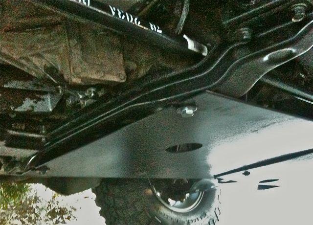

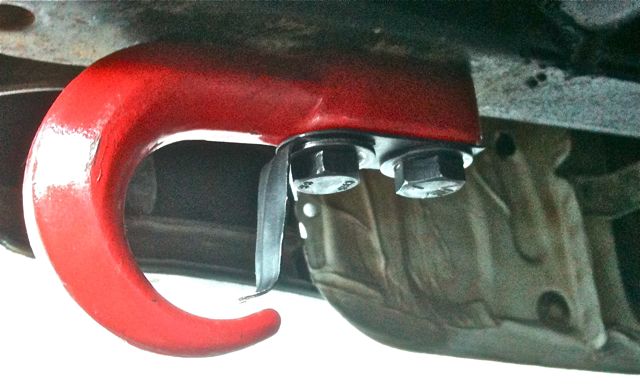

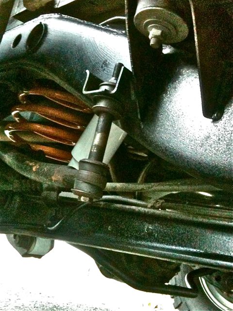

Just received "Whitey" back from Gomad 4x4 workshop today. Attache photos show the work done - ie. two-piece 4mm bash plates, rear recovery hook, chassis painted black.
Other mods are the Ironman suspension, done by First Alignment Centre & the BFG's KM2 mud tyres
Only need to sort out my driving / steering wandering, whilst on the highway. Not B/Joints nor T/R/E's....already changed them :? :?

Achille,
That's another neat job. What did the hook cost? I always wondered why Pajero does not have a rear point.
Hi Anton
I just sent you a PM ....did you receive the dropbox entry??
The hook was R105, if i remember, but they had to drill one hole, to align the 2x bolts.......was strongly advised never to use the towbar, as a rear recovery point.......makes sense too :geek:
Yes, the 4x4 w/shop guys have done another satisfactory job.....yet again :D
