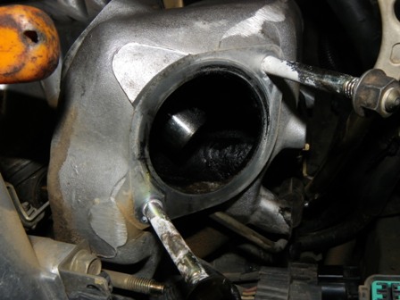

inlet manifold
inlet manifold

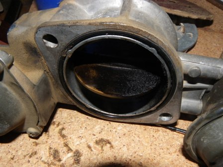

throttle body
throttle body

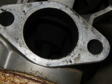

egr inlet
egr inlet
egr valve
egr valve

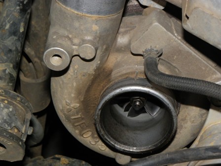

turbo
turbo

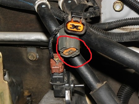

I have noticed that this wiring plug does not connect to anything. Is this correct or is there something missing
wiring
wiring

Yours doesn't look too bad but worth the clean.
After speaking to you i remembered some more bad news. I had to remove the tappet cover to get the pipes that go into the head back on the injectors...... You may be lucky and may not need to do this. Do that part first when reassembling and then connect to the pump.
To clean the intake spray with brake cleaner, leave it for a few minutes, hose off with pressure washer. Repeat until satisfied.... An old toothbrush helps. ;)
That connector at the boost sensor is disconnected at mine as well. Dont know what its for.

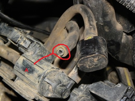

You need to get that vacuum nipple sorted. Its either the cut off diaphragm solenoid or the idle solenoid. Look here
is the item circled in yellow the vacumn nipple. I see that there are 2 off these on this unit. i there take it there should be 3 then. I dont have any problems with idle of killing the engine
thanks and more stripping :mrgreen:

Thanks I did. Just need to sort out the nipple.

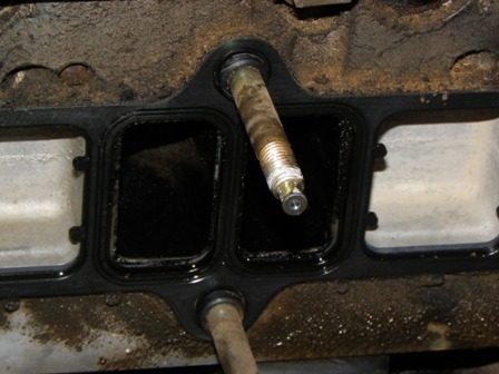

:idea: Made a 19 mm ring spanner with an open end for the fuel pipes on the pump side. Could not part the brackets holding the pipes together, but pried them apart later as this helps when re installing. The manifold did not want to come loose, so a little help from a rubber mallet and she eventually moved. Replaced the old gasket as this was hard

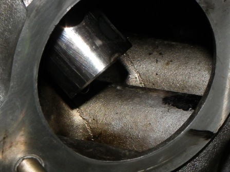

Some pics before cleaning

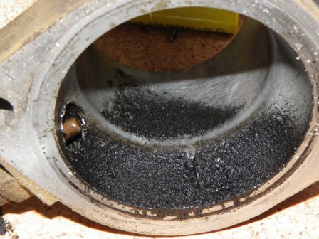

dirty inlet
dirty inlet

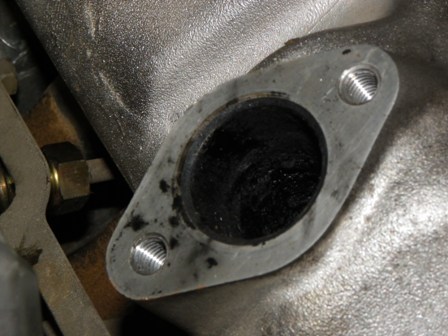

cylinder head side
cylinder head side
stripped inlet side
stripped inlet side
Started to re assemble this afternoon and was very anxious to see if she will start, so I just connected all the components needed to start. Did not need to remove the tapper cover to install fuel pipes, just a little oil, some movement and patience. :D :D

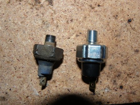

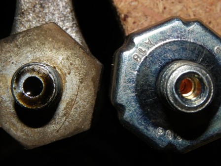

Replaced the oil pressure sensor. Noticed a small difference here :?: :?:
old versus new sensor
oil pressure sensor
oil pressure sensor

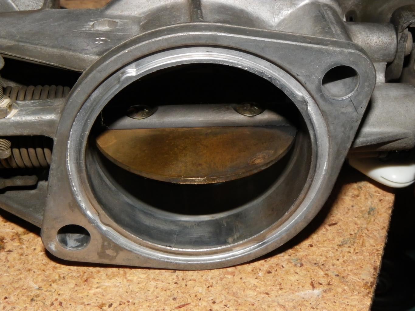

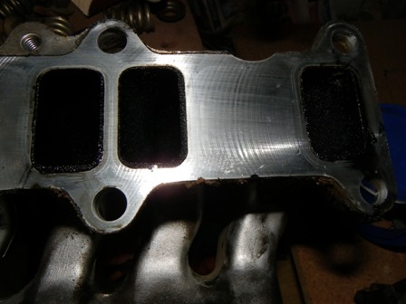

Some pics of clean items before assembly
cleaner manifold
cleaner manifold
clean throttle body
clean throttle body

I noticed that the intercooler pipe had been touching the pump pulley and was worn through. Priced this from the agents and at R 1000 rand, I have decided to make an alternative solution. Will see if I can split the pipe and install a stainless steel centre section :?: :?: :?:

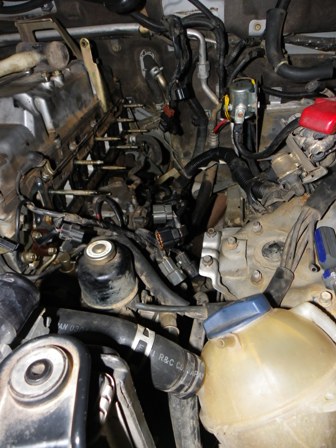

Re: 3.2 DiD Inlet manifold cleaning
Thats a weird overflow bottle you have there. Looks like a VW part. Mine doesnt look like that.
Sent via iPad & Forum Runner
redvers
That is a VW part. Previous owner installed it and I don't know why.
