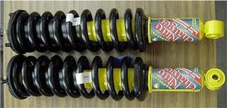

Hi Guys check this link maybe it will give better understanding of shocks.
