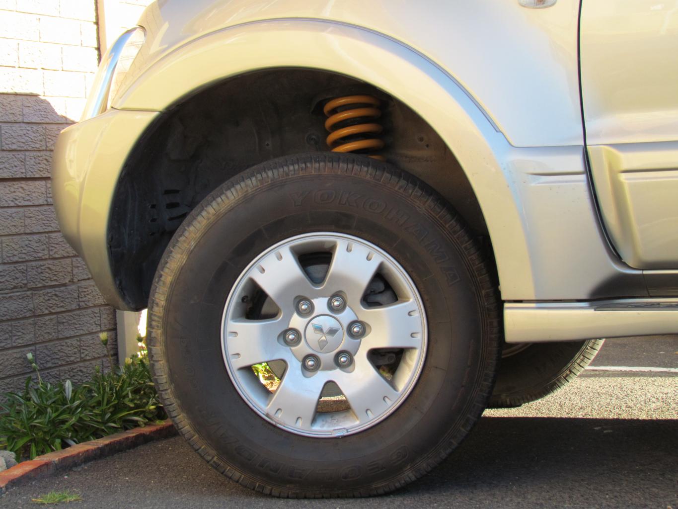

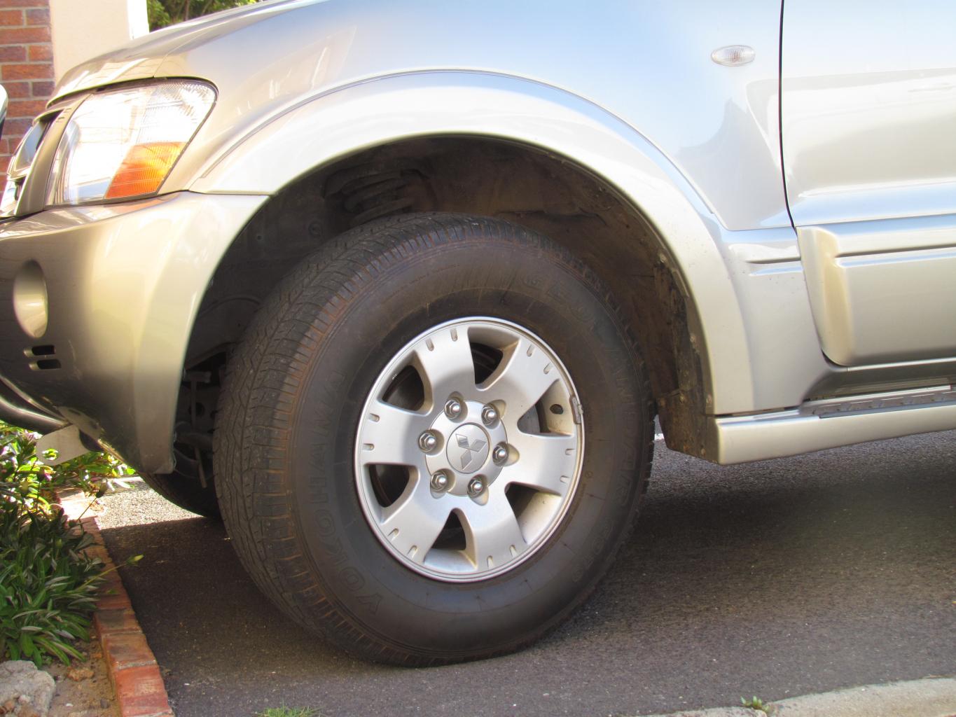

So im new to the Pajero and the forum but just needed to show off my first mod.
Came back from a three week trip through Botswana in October with the realisation that i need extra height, so here it is!
Replacing the coils/springs gave me a 55-60mm lift in front and a 50-55mm lift at the back
Next is rocksliders (any ideas or designs available) and then bigger tyres (265/75/16)

Which coils/spring did you install - OME? Did you only do the coils/springs or did you install new shocks also?

I was keen on OME but i ended up installing Ironman coils (got a super great deal) couldn't resist. I have heard they are not as good as OME so we'll have to wait and see how long they last.
I just did the coils as all the reading & research i've done shows that the standard Pajero suspension has a very similar stroke length as Ironman/OME. Time will tell so far all is good I haven't tested it out off road yet as im only in week two but i have booked the Babylonstoren trail for 7 Jan so i will soon find out.

Nice, I like the lift, looks really good, a nice set of AT or MT tyres would look good there too

The whole job, coils, installation, wheel alignment, and balancing cost me R5250 including VAT.
