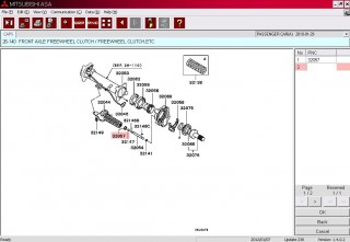

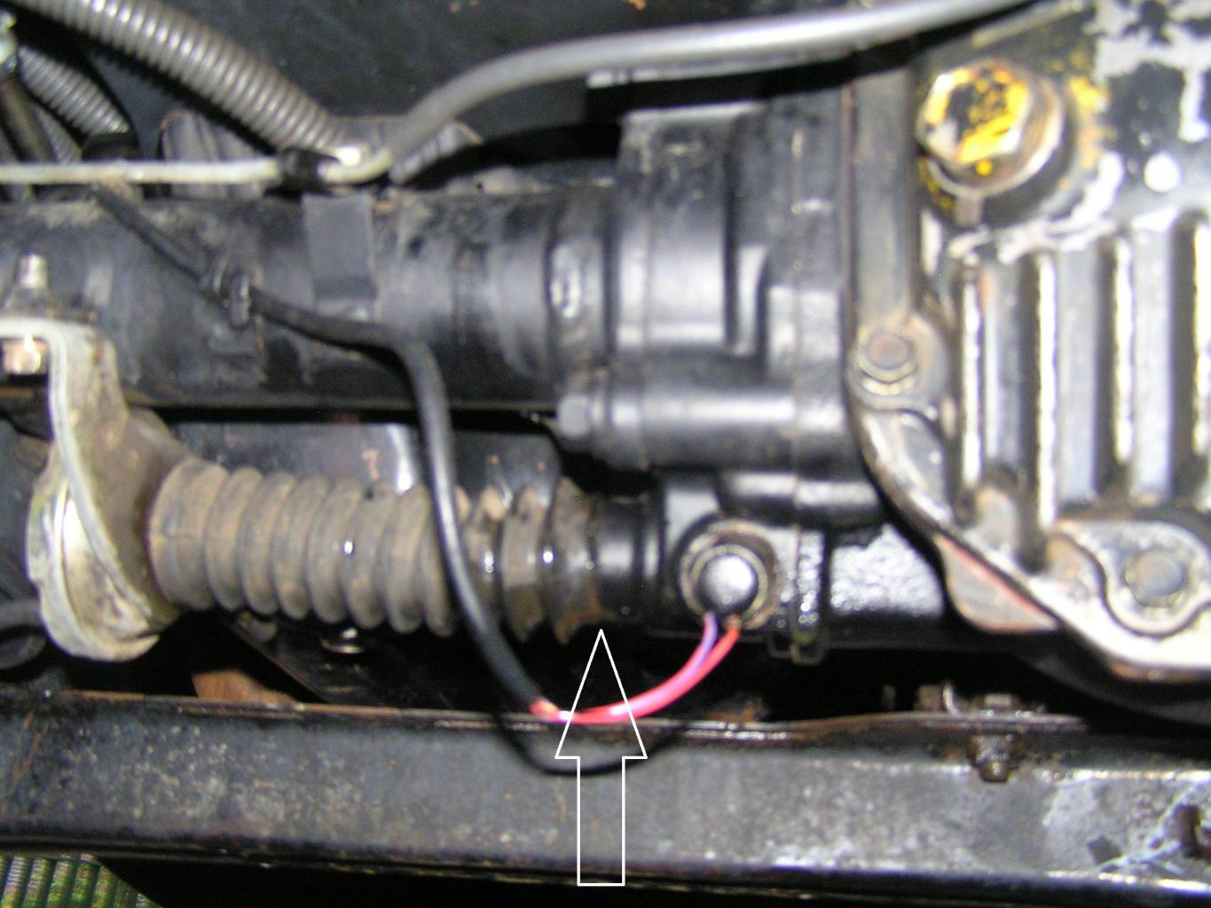

My Pajero (2003 LWB 3.2 DID GLS) developed a leak on the front differential

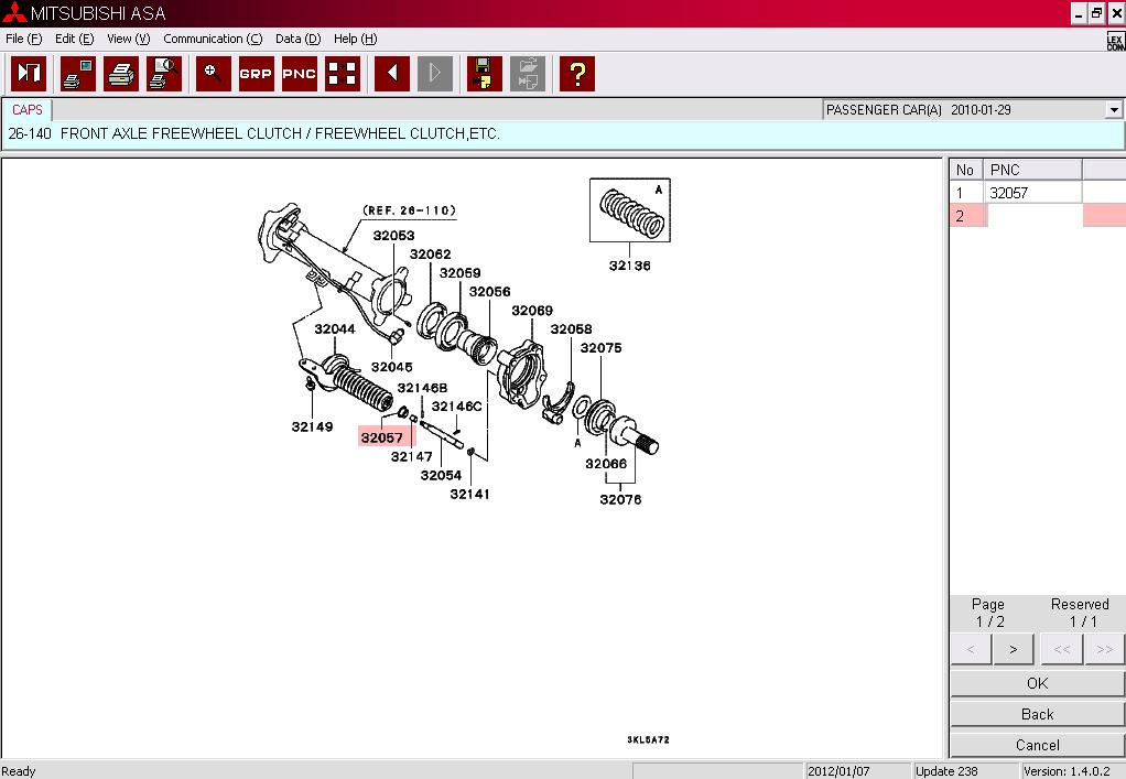

Marius, I am sure you will be the one with the correct answer. Please see the photo below:
Thank you,
Waldo Fourie
The number on the image is the PNC number (Parts Name Code)bold4E wrote:Thank you Marius. Please explain why the part number is not the same as the number on the diagram.
