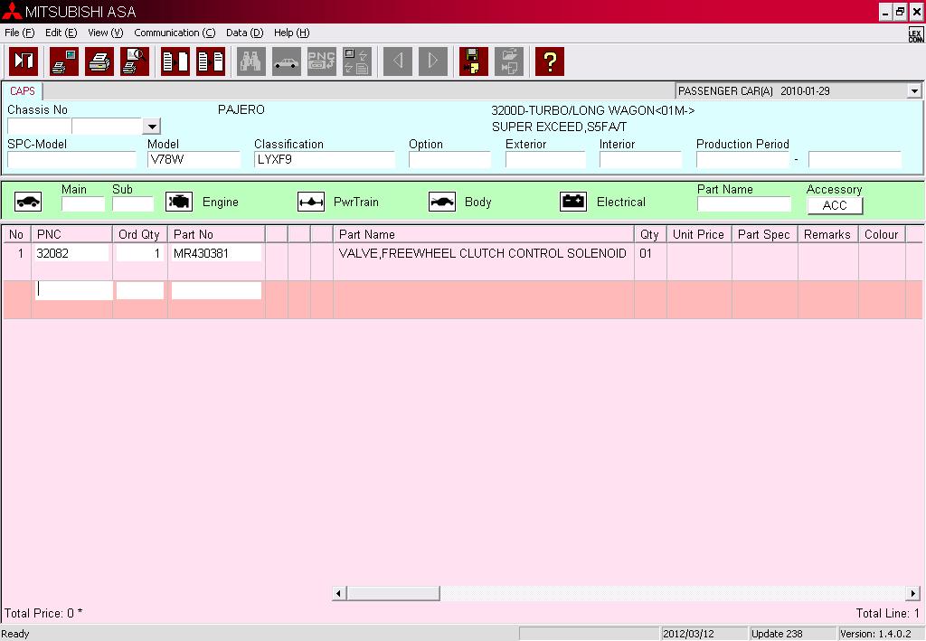

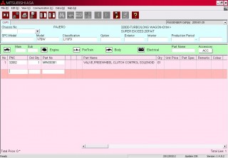

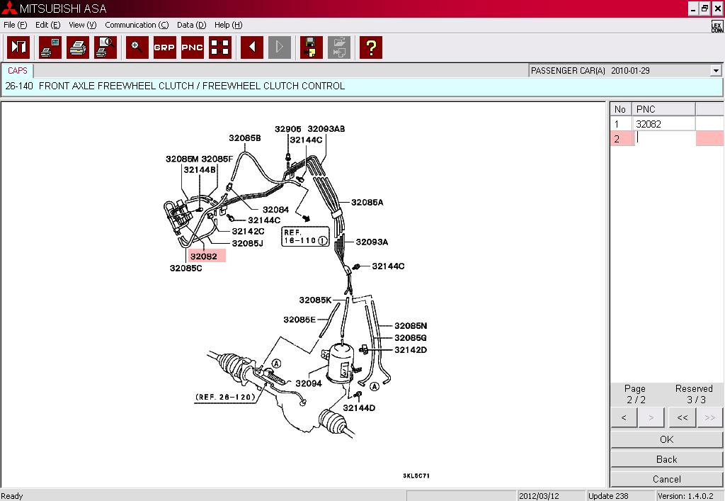

Time ago I had this flashing light on my pajero 2004 (ambar light) that comes on after some 20 to 30 minutes of drive, after some checkings and cleanings on the solenoids I could make them work, but now they are failing again so for me it is time to replace them, I went to visit the mitsubishi dealer in Mexico but they had no idea what this solenoids are so they could not find the part number. the quiestion for you guys is: does any one here knows the part number for this solenoid valves??
