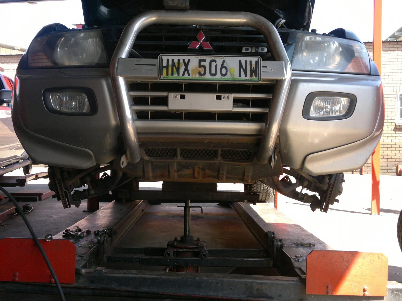

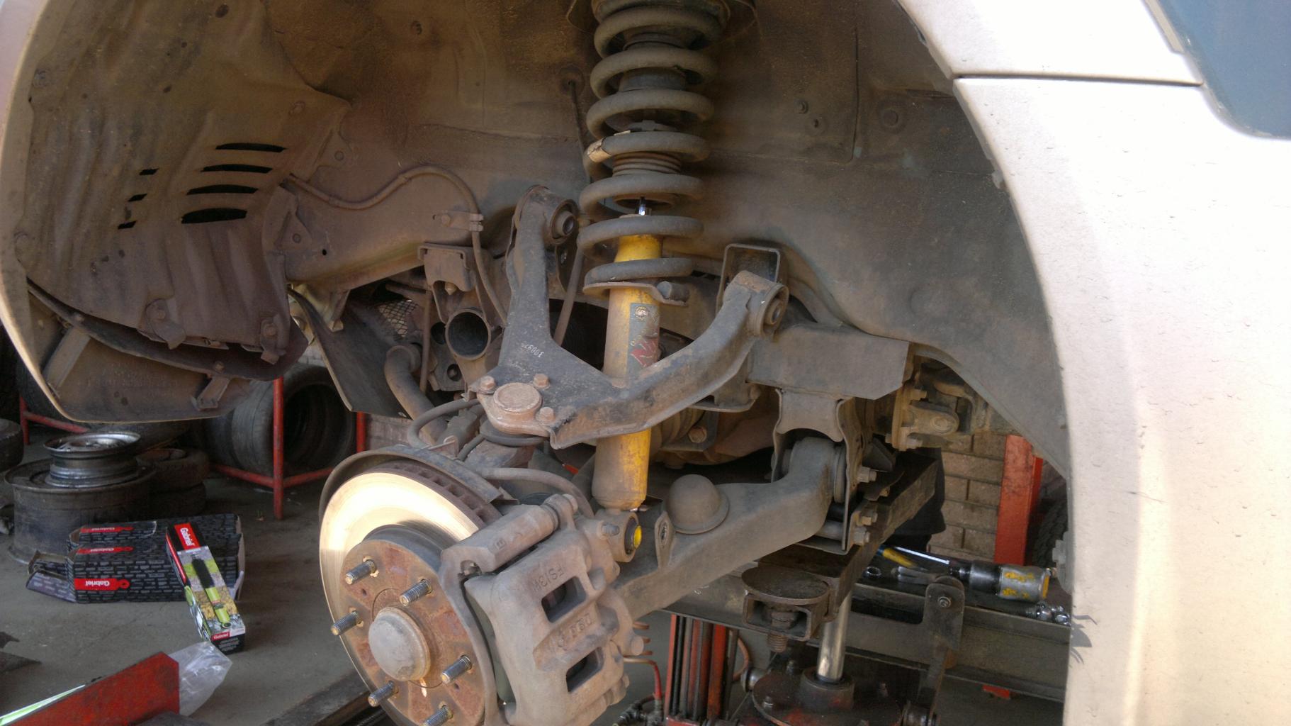

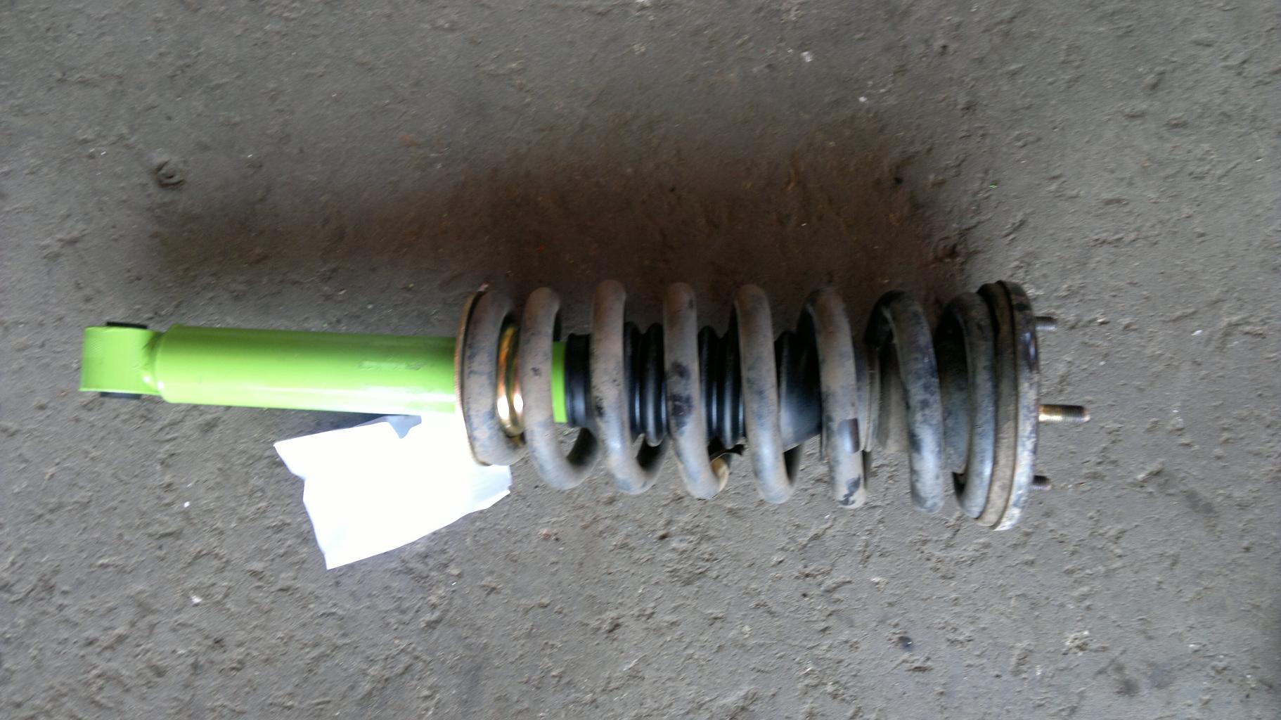

I had my PJ shocks replaced a week ago. I will not do the front ones on my own.
Here are a few pics from the front ones.
To get them out they had to remove the battery and overflow water bottle and the air cleaner box under the hood to release the suspension tower.
then they had to remove the bolts keeping the control arm in place to get the shock and coil out.
then they had the shock and spring in a clamp to remove the coils from the spring and then compress the new shock in to the spring. then they were two to re assemble the suspension tower in front, one lifting it into place over the control arm and one under the hood to fasten the bolts.
