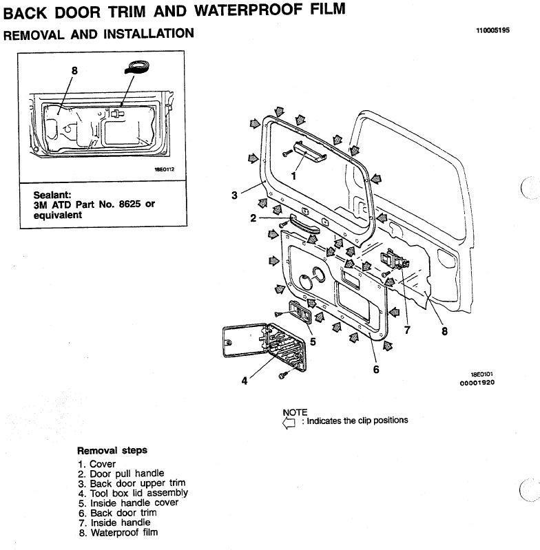

You can open it by taking of the back door trim from the inside. You only need to open it wide enough to get your hand in, carefully cut the plastic dust sheet and pull the latch

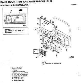

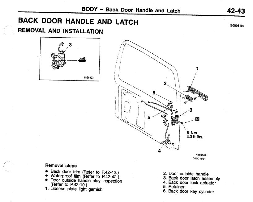

How the trim hangs together
You will need to pull the rod attached to the motor (4) downwards to release the door catch.
If the door catch itself is jammed or bent you might have a problem, but usually its just a case of alignment
