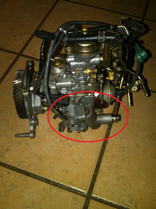

After a lot of research I found that the VE pump has a KSB, cold start device to compensate while the engine is cold. The KSB on my Pajero however is removed by the previous owner.
I would appreciate it if there is someone who can help me source this part, as i am sure the manufacture will sell the complete pump.
