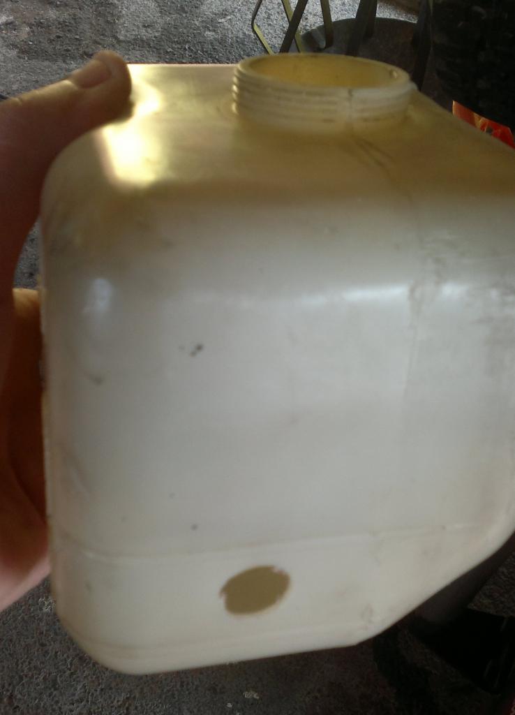

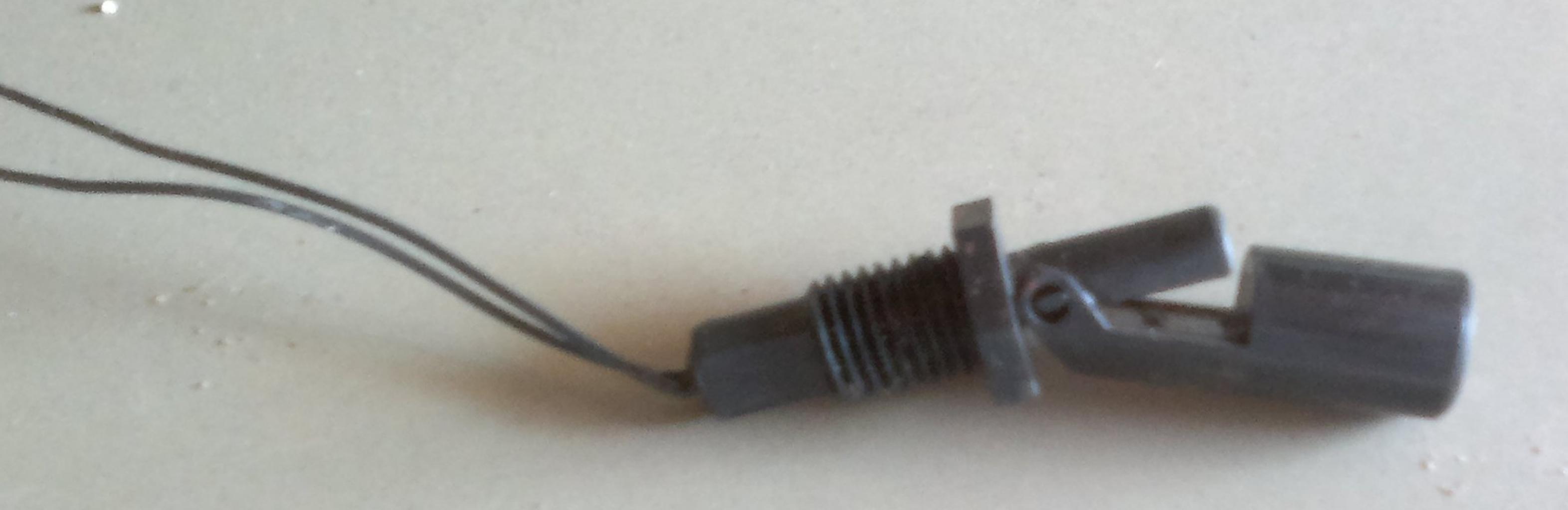

I had a float switch in the garage which I used on another project. Think they sell for just over R100.

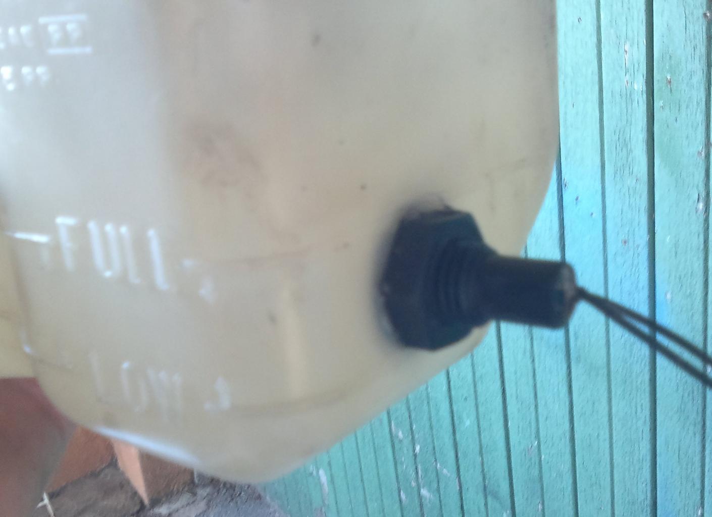

I drilled a hole in the filler tank and fitted the switch inside routing it to a light on the dash.
Real easy job - the most difficult part was getting the wire through the firewall into the cab.
I posted some pics.
Some pointers:
I made sure the switch is in the "light on" position when the car is still cold so that I will know the light is still working fine.
As the car heats up, the water level rises and the light goes off. If it stays on, or comes on again after it when off it should spell water loss.
Used a flashing LED which takes almost no power as the light will be on permanently through the night (unless you wire it via the ignition which I failed to do).
