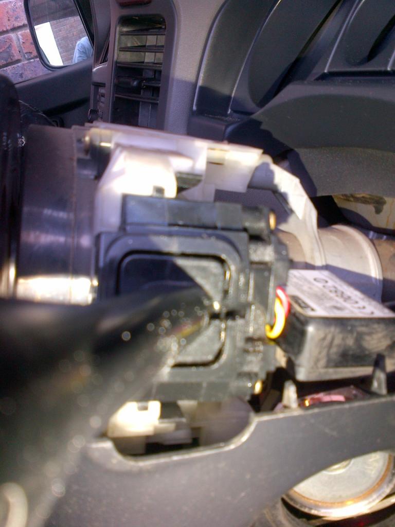

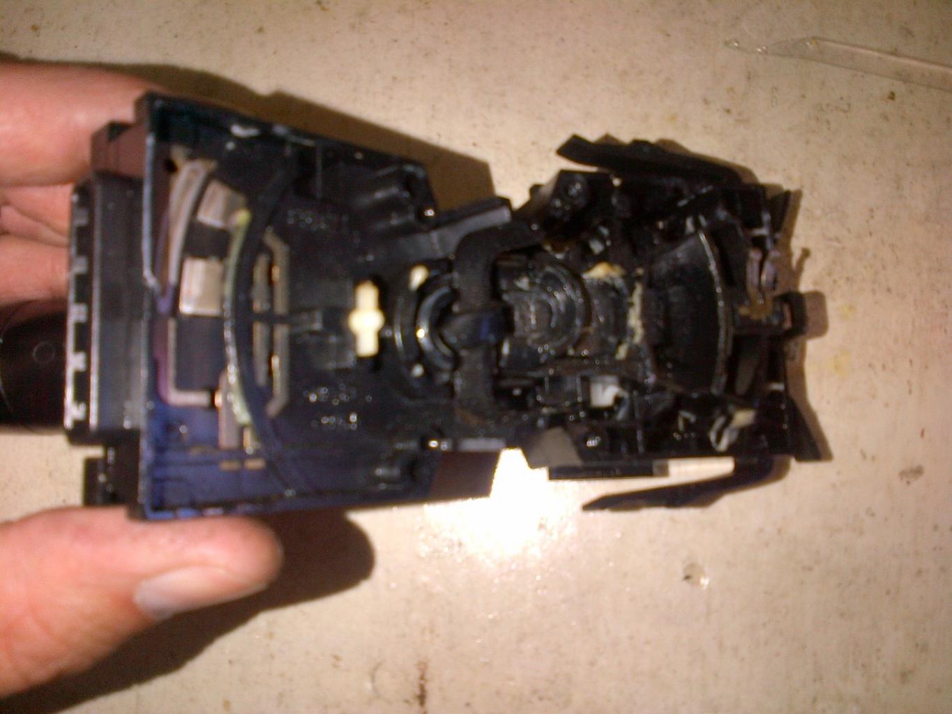

Yesterday I removed the indicator unit, which is quite an easy task. I took a chance and opened the actual unit. It is a very simple contact system inside, which I cleaned a bent the contacts slightly etc. We shall see if it works. See the attached pics.
It is a very simple operation to perform. Remove the 3 screws holding the black panels around the steering. Seperate them and see the clips (top and bottom)holding the indicator unit in place. Press inwards and pull the unit outwards. Once you have the unit out, remove the 2 screws and gently pry apart. When reassembling, push the white plastic part in and gently pair the halves, then put in screws and clip back onto the steering column.
