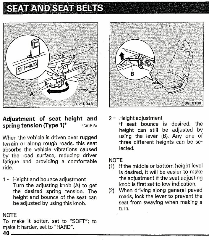

I have always battled to fathom the settings below the front seats of my Gen 2.
All the settings feel the same to me, any advice will be welcome.

From the manual:
